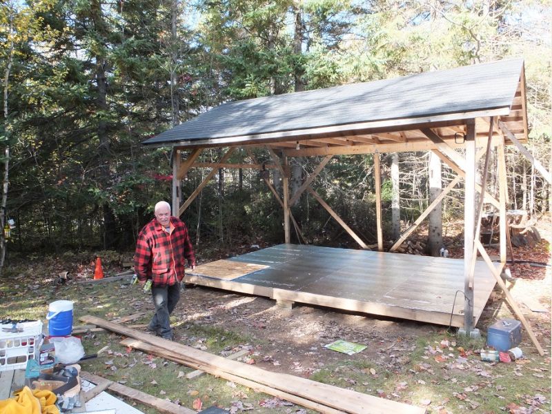

  Below (picture) is the 2x6 floor with the 4 strips of reflectix on it, followed up by the first 1/2 sheet of OSB. In the picture it might look like the joists run the long way (side to side) but that's just the waves from it being rolled.  The joists run front to back.
  Oh, and we laughed at the warning on the package about being careful when working with their product in direct sunlight.....until the sun came out.  I kid you not, if it's sunny out, wear sunglasses.
  And the picture, yes, the floor is sitting almost on the ground, and you're thinking what's with the posts..and why is there a roof before the floor....?  The roof and posts were built several years before, and a slide-in truck camper served as my cabin for a bunch of years, with the future plan to be to 'just lift the roof, build under it, set it back down on the walls'.  Sounds easy when you say it, right?  Anyway..that's a whole other thread. [img=null]null[/img]

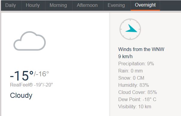

  If anyone's interested, Saturday night is supposed to be -16c here.  Where the camp is has some more altitude to it so it's always a couple degrees colder.  I could record some inside/outside/head-height/floor-height temps....again if anyone wanted to know.... If so, new thread, post results here?  Does anyone even care?  haha
