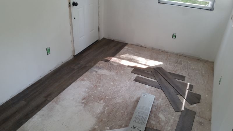

I used vinyl in my unheated 8 x 12 bunkie and it's been fine so far. I like that standing water won't bother it - teenage boys aren't particularly careful about wet bathing suits / towels / spills. I haven't had any issues so far and I'll likely use it for the building the composting toilet is going into.
I was quite particular to make sure that there was nothing on the subfloor before I laid it down as the vinyl is quite thin and I figured anything under it would be apparent.
