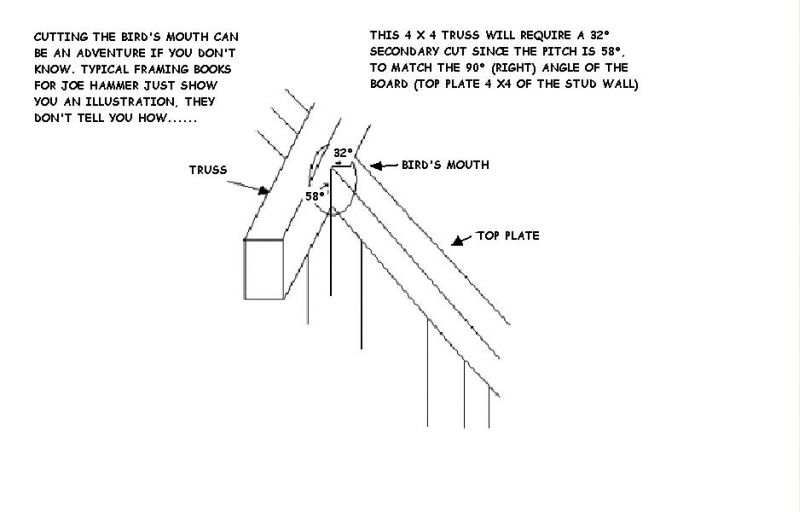

"I got a lot of plans with 4 large windows and a small loft. I just need to figure out how to cut birds mouth cuts for the rafters tha sit on the top plate. I want an open rafter with a 2x10 main beam and tie rafters into that. I will have to shoot from the hip and build as I go."
If you really want to go old style and cut bird's mouths, here's an excerpt from my journal. My experiences are a ways off from the MtnDon genre, but nonetheless, would like to share;
I have chosen a 58° pitch. I determined this from an on line calculation (http://blocklayer.mobi/RiseRun.aspx) don't ask me how I found it, but what a grand site. I entered the run (half the width of the cabin, 5 feet) and the rise (the height I wanted from the top of the wall, 8 feet), and it determined the degree of pitch for me. I've been told this is a trig function...no wonder I couldn't readily figure it out........ The bird's mouth was another poser for me, but in direct relation to the degree of pitch (so no short cut guess work on the pitch, OK?).
The simple key, once you determine the pitch (say 58°) you just find the remainder of 90° for the other cut (32°).....Wow! Duh!. Once you think about it, it's a no brainer. You just need to create a right angle (if you are using square or rectangular boards.....if not, put this book down right now, flush, wipe first, and proceed to your doctorate in structural engineering).

As long as you make your roof such that it covers the siding and keeps the water off (2' overhang), pretty much anything works for siding. I like live edge planks myself, if you have the means to cut them.
Rafters are quite a bit easier than folks think. Install the ridge, install the plate, lay a board up where you want it, use a straight edge at, say, 1", mark a horiziontal and veritical line on both ends of the rafter where you want it fit, then cut it. If the rafters are all the same, use this as a pattern.

GaryO and fpw thanks for the help. You both gave me some info to get started. Like you said if I get one cut out it will be th epattern for the rest. Thanks again for the help.
