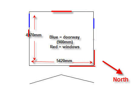

Hi everyone, I have just purchased remote bushland with an unfinished cottage. Foundations, walls and roof are all done. The interior is just bare framing and the floor only has bearers and joists. Its single story and sound. I need some help with a possible accommodation layout if you're interested in helping. The internal dimensions are: 5.420m x 4.970m (17.7ft x 16.3ft). Its an absolute blank slate. We intend to use it as a weekender for 3 adults (we have an adult son still at home) while we build the main house in slow time. We need a kitchen, eating/sitting area, sleeping area (bunk beds are ok), toilet/bathroom with shower. Nice to have would be laundry/utility and 2 seater sofa (happy to have sofa act as bed). If you're up for a creative challenge please share your ideas. Your input is very much appreciated. Thank you. Regards Neil
MikeOnBike
# Posted: 20 Feb 2011 09:47pm
Welcome Neil! Can you give us an idea of the window and door layout? Maybe a rough sketch you could upload?
NeilR
# Posted: 20 Feb 2011 11:56pm

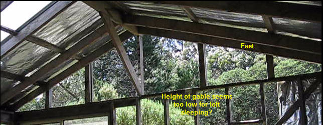

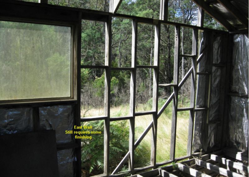

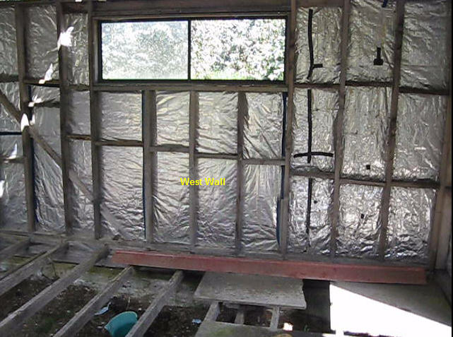

Hi Mike, Yes. I should have done this earlier as I have a couple of pictures too. layout of doors and windwos
|  east and north walls
|  eastern gable
|  east wall

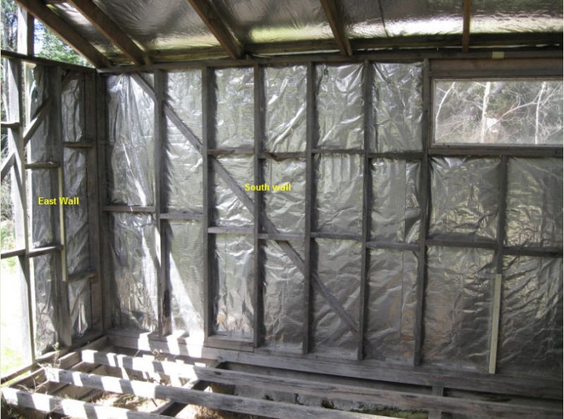

NeilR
# Posted: 21 Feb 2011 12:02am

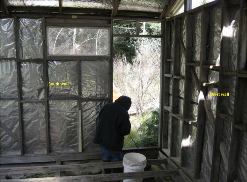

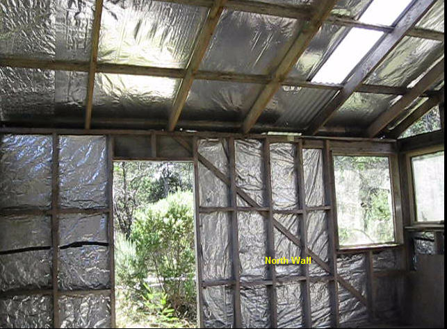

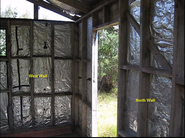

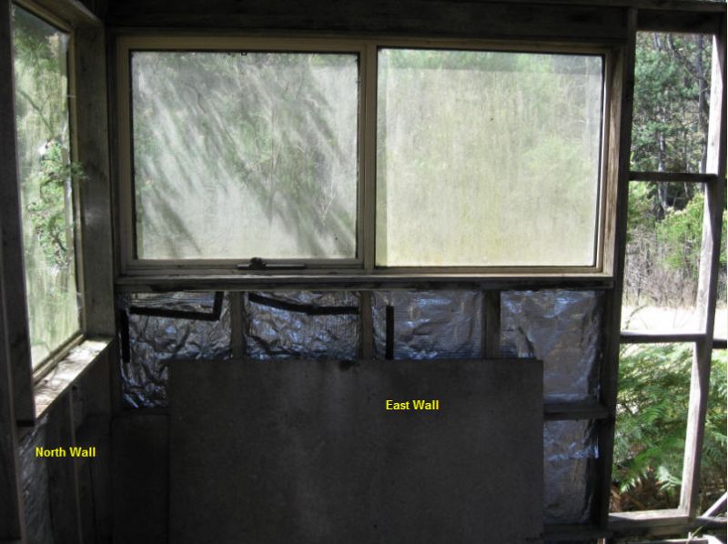

....and a couple more.
REMEMBER we are back to front in the southern hemisphere...North = good sun :) north and west walls
|  north wall
|  south and east
|  south and west
NeilR
# Posted: 21 Feb 2011 12:03am
....last but not least

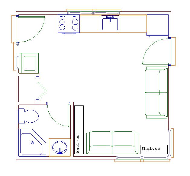

Ok, it's midnight here and I threw together a quick stab at it. The cabin is really quite small for everything you want. The sofa are futon or sleeper type. The machine next to the closet is a stackable washer/dryer. The area in the middle should be enough room for a small table for two. Your loft looks less than a meter high. That would probably work for storage but it seems a bit cramped for sleeping.

Maybe a better layout since the north windows are not picture windows. v1 might be better if you are focusing on a TV.

Looking good Mike. Yes, agree its pretty small but its what we have to work with. I will contemplate putting a new roof on for a sleeping loft but not promising just yet. Also the addition of a north and eastern deck will assist to "spread out" I think. May even be possible to enclose the deck too. Autumn is rapidly approaching so I want to get this comfortable within 3mths of weekends. I forgot to mention the doorway on the northern wall is 1200mm (4ft) in from the west wall if that assists. Thanks for your interest and support. I really appreciate it.

I assumed 3ft for the door so it doesn't change the layout much. It will put the futons a little closer but they can still probably be nudged a bit at sleeping time to open out ok. One of my kids had a futon bunk bed growing up. They loved it, I had to watch my head getting up from the futon couch.
I have space constraints too. Our 2010 project was 10x12 w/loft and the 2011 project will be a 10x14 wo/loft. I don't have expectations of a bathroom but it is still a delicate dance to get everything else in that space.
After tent camping for several years while we worked on road access and fencing to keep the cows out we have found the simple shed to be luxurious. If it were mine I would not fuss with a new roof. I think you have enough room for what you outlined. There are many other things at your camp that will consume your time. Make this livable as quickly as possible. That is the approach we have with our sheds. If the sheds are too nice we may never build the cabins. Keep it simple.
