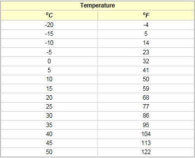

So...Here's what I measured out over the weekend. All temps are in Celcius. When you view the image after clicking below, you can click the image and it will zoom in.
(I added a Far. equivalent in the graph picture, you know, for the 3 countries on the planet that don't use the metric system. hehe)
Temps Table
Temps Graph
Conversion Chart
