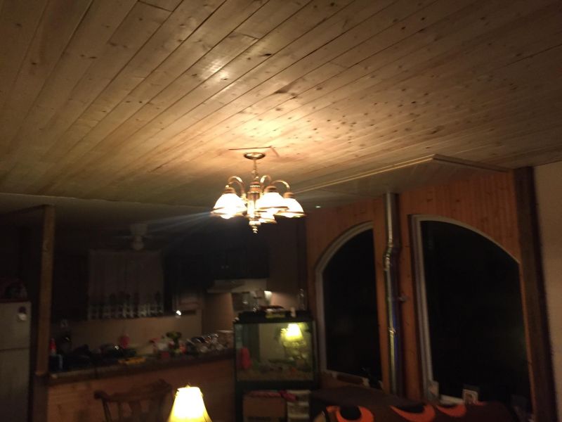

# Posted: 5 Jan 2019 06:31pm

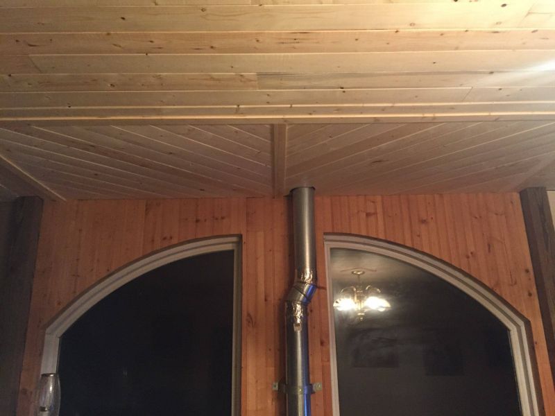

Just did this in my buddy's cabin 2 weeks ago. It was the 3/8 thick stuff from home depot. Easy to work with but had about 30% bad boards in the project. Ceiling
|  Changed pattern around windows

Looks great! 6 inch boards? Are those the same boards on the wall and ceiling just with the smooth side out on the ceiling?
# Posted: 5 Jan 2019 08:33pm
I think they are only 3 1/2 inches. The wood on the walls is bead board.

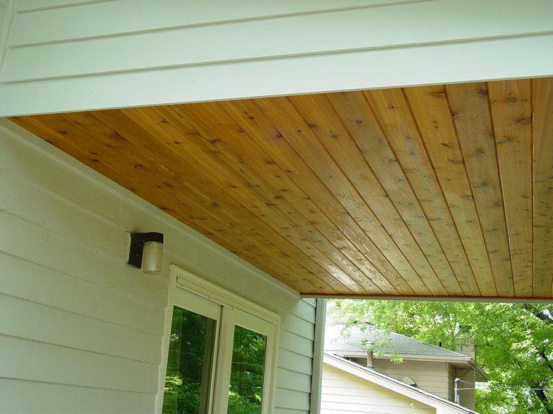

Its really up to you. The wood on the ceiling had 1 smooth finished side. My buddy wanted the knotty pine look. I don't know if what you looked at is the same type. I myself would use t&g car siding. It comes in longer lengths and is 3/4 inch thick. Also wider so faster installation. My friend was penny wise but pound foolish. He saved $ on the wood, but lost more on labor cost. It cost him the same amount of money to have a guy pick up a bad board and move it to the bad pile, as it would to pick up a board and install it.
# Posted: 5 Jan 2019 09:26pm

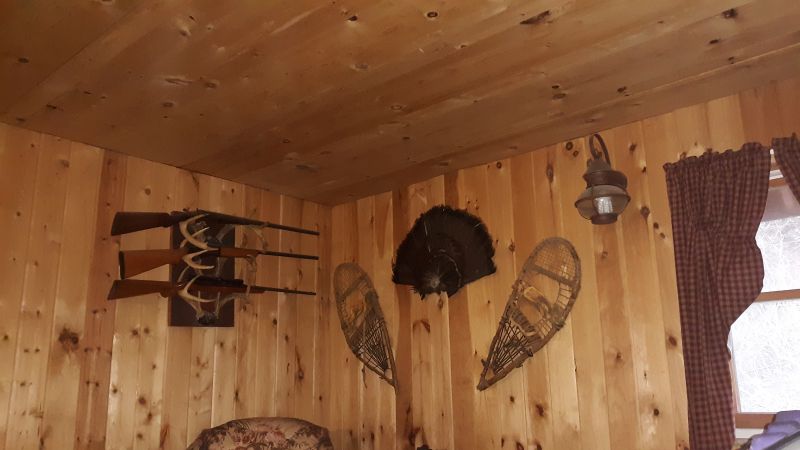

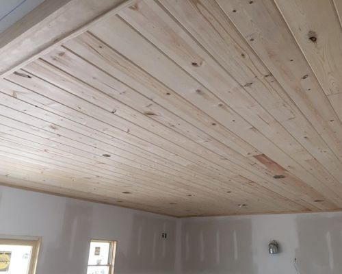

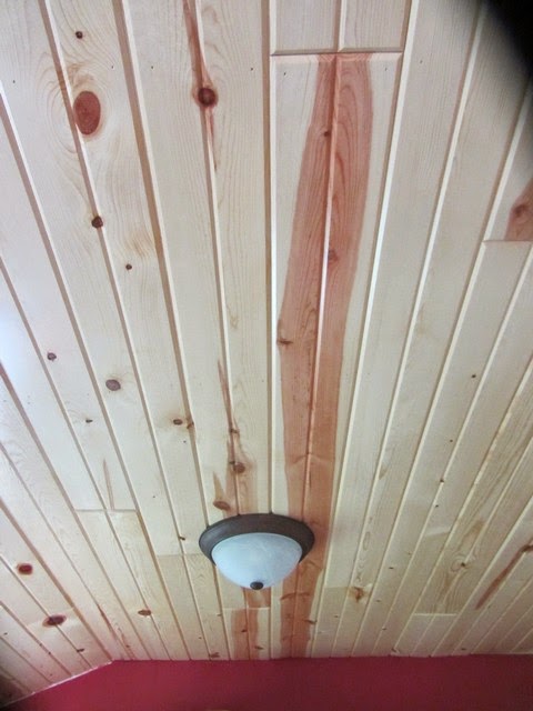

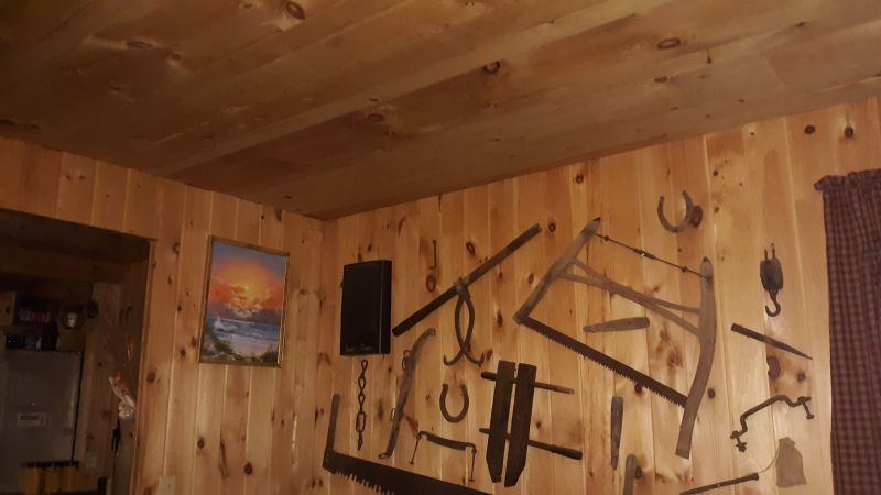

My ceilings are all 3/4"random width pine planking and my walls are 3/4"x 6"tongue & groove.This is Canadian pine with the big knots.I have had no trouble with shrinkage. I think there is enough play in the depth of the grooves to hide any shrinkage that does occurs. The 3/8" packaged pine breadboard that you can get does dry out and shrink badly exposing seams. 20190108_125401.jpg

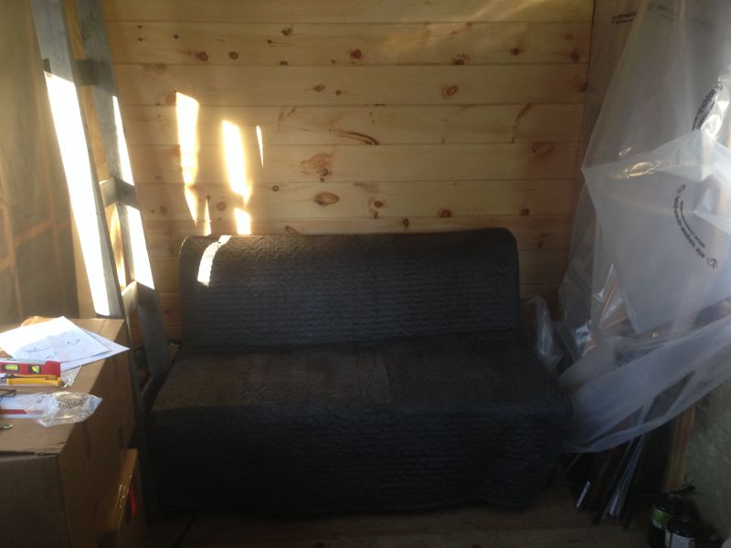

This is our siding from HD. 1x8. We love it so far.

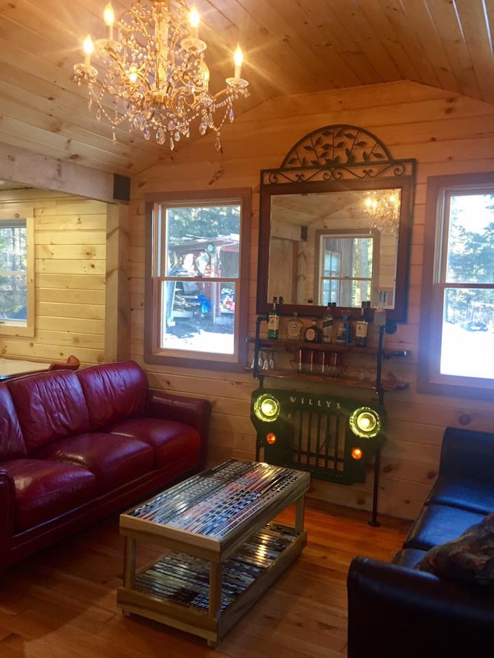

Not the best pic but you get the idea
