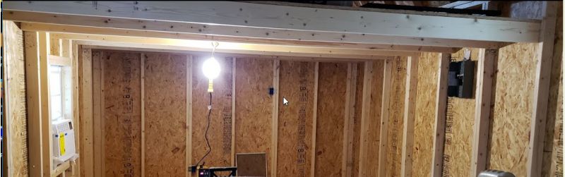

I don't think I saw anyone specifically mention the pros/cons of sistering boards. What if I cut it down to a 2x5 and sistered a 2x4 in? What if I used a different kind of wood for sistering, or some other material? What if I added 2 sister boards?
I don't have a great pic of the loft but here is something.

Not to be sarcastic, but why would you go to all the work to modify the current 2x6, which is a little underrated in the first place to gain just 2". If the loft is not used that much I'd put my effort into raising the 2x6 since they don't appear to be resting on the headers.
# Posted: 11 Jan 2019 10:31am - Edited by: KinAlberta
Quoting: Tonerboy
I see that now. If it were my problem, I’d unscrew the decking and pull the nails on the 2x6s and then start fresh. I suspect that it would go very fast. (Years ago I bought our house and it came with an large older poorly placed deck of 2x4 cedar and 2x6 fir framing all put together with drywall screws. Taking it all apart went amazingly fast. And I was able to save and reuse thousands of dollars worth of good wood.)
