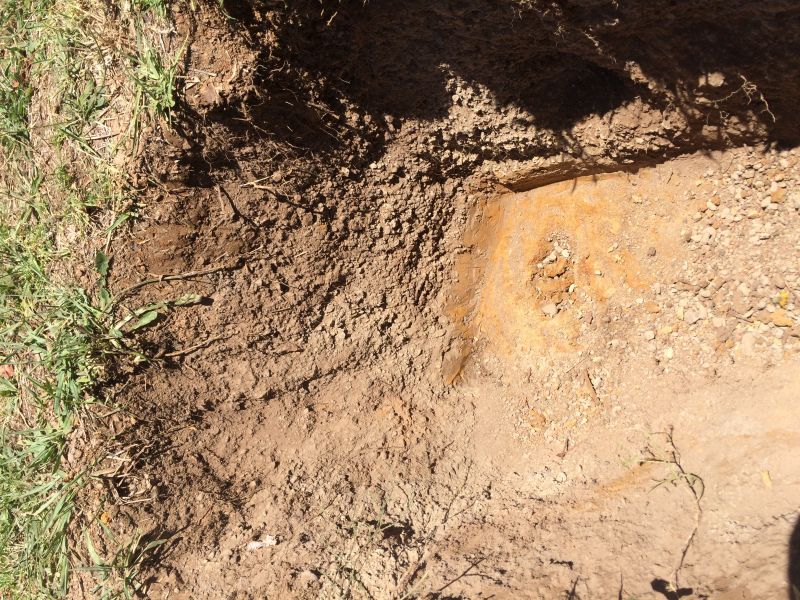

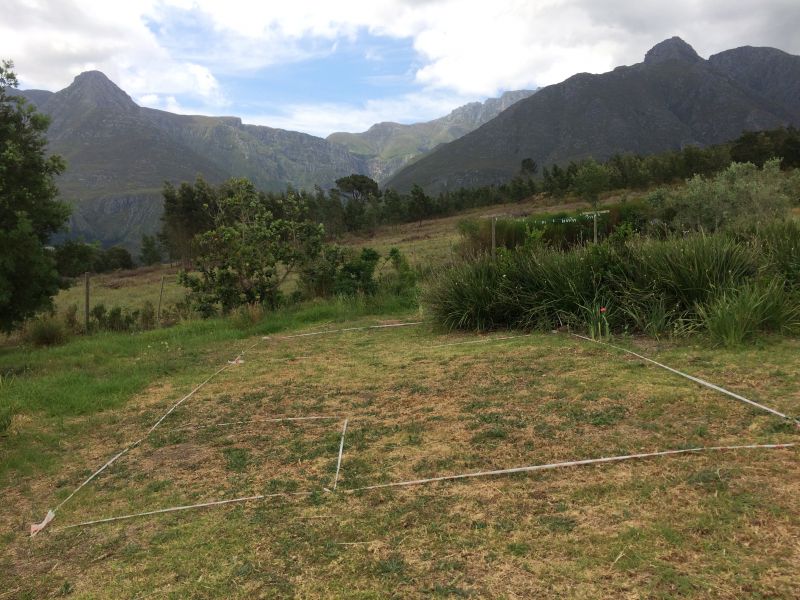

Thanks for the replies! Some pics attached. I was thinking to scrape off the 6" of Loamy Sand to be used in our gardens, as it is very precious here. Very few people do wood frame here in South Africa, as the relatively cheap labor and expensive wood encourages concrete and brick work, but I am looking . I'm pretty familiar with drainage systems, so that one is covered. Regarding bringing in extra soil to level vs digging in to level, in both cases doesn't having different depths of soil over a clay base affect the stability of the skids? Specifically, could I put one skid on pads that are on 3 inches of sand directly on or even in the clay, while the other skid is on pads that are on 3 inches of sand that are on 12 inches of sandy gravel which is on clay? Building Site Layout
