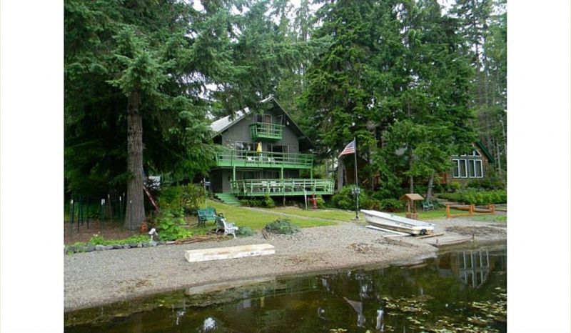

# Posted: 3 Feb 2019 12:54pm - Edited by: toyota_mdt_tech
  But gable ends facing lake is traditional, and lots of overhang. How about rafters vs trusses and exposed on overhang? Close it in only at rafter tails, leave gable overhangs open? Set overhang out far enough too, sun low in horizon in winter, allows sun to come through those windows and heats your home. High in summer, keeps sunlight out and cooler. My dad did this to the house I grew up in, he built it, was on the lake facing south, I remember massive solid doug fir beams, load bearing ridge etc, Rafter ties/floor joist for upstairs were 4X14 every 4 feet.  my childhood home on lake

  That's a nice place! I work for a local building supply company with a truss plant and with large snow loads and being engineered trusses I'd have piece of mind knowing my cabin will be ok. I work doing interior work finish carpentry drywall paint etc and not much of a framer and wouldn't know where to even start with doing rafters.
