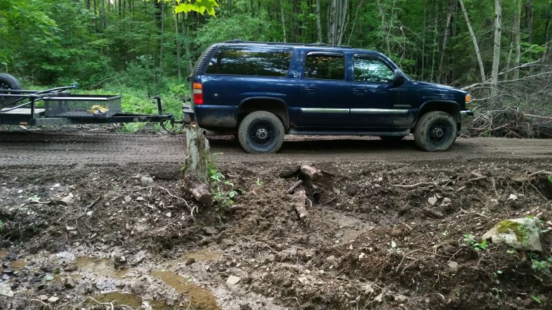

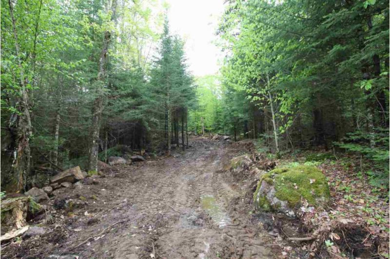

I assume a lot of you constructed your own driveway to your cabins....so how'd you do it?
I've got a quote from a contractor...and I'd rather spend the money on a foundation or excavator work.
My drive is already cleared, de-stumped, and roughed in...but there's plenty of rutted topsoil left.
I have access to a tractor and part of me says "don't overthink it" (or overspend)....just scrape it as best I can with the bucket, lay down my gravel, and spot treat as needed when needed.
The other side of me says it will be a washed out, rutted mess again in a few years and spend the money now so I don't spend it later.

I have not made a drive... However I think before spreading any limestone or gravel. It would require a drainage ditch along the side or at least be elevated above the surrounding landscape to allow the water to drain off. The deeded path to the many cabins we take is not maintained and looks similar in appearance. It collects a lot of water, it is not a path that you want to take an ordinary vehicle down, It does keep vehicles from entering as they may not get out. It has culverts in where the water is really bad which helps keep it off the path as well. (These areas are also raised- I could only imagine how much worse it could be without them.
I think clearing a path is only a very early first step.
Although the left side appears that it could help with getting rid of some of the water. Just something to think about...

Quoting: bronco_ed Just something to think about...
Oh I'm definitely thinking about ALL of that.
If this was super long then contracting it out would be a no brainer, but 95% of the drive is shown in that picture...so it's not very long (Maybe 200-250 feet).
I don't know if I'm kidding myself on what I could accomplish with a tractor bucket and backhoe attachment though.

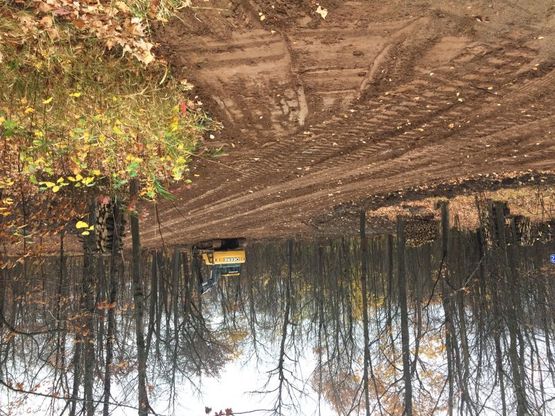

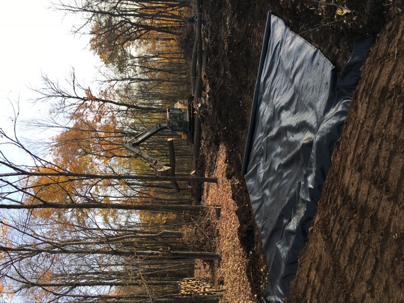

mojo I built a 900 ft driveway on soft farm soil with a small tractor with front end loader. you can search the post here on the site.
I cleared the green stuff on top. Rots anyway. I put down road tarp. I searched around a found a small distributor who would sell 12x400' rolls to me. It wasn't cheap but it wasn't that bad either.
I then had the local quarry bring in 3". Put down a layer 4-6" deep. I then put 2" of 5/8".
To save money I back dragged the aggregate with my fel. Leveling took time. It was loud and fun. Very satisfying when done.
The first part of the lane is over 5 years now. Looks like new.

Quoting: creeky I put down road tarp
Geotextiles. Great stuff and needed in many places. Road fabric is a permeable woven geotextile that allows water on the surface to flow through the gravel to the soil beneath, but is strong enough to reduce rutting and restrict subgrade soil particles from working up into the gravel surface (pumping). Without it the gravel you place sinks as you drive on it and you will be adding gravel layers forever.

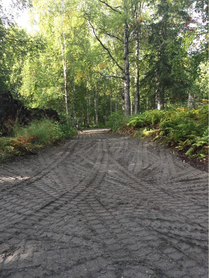

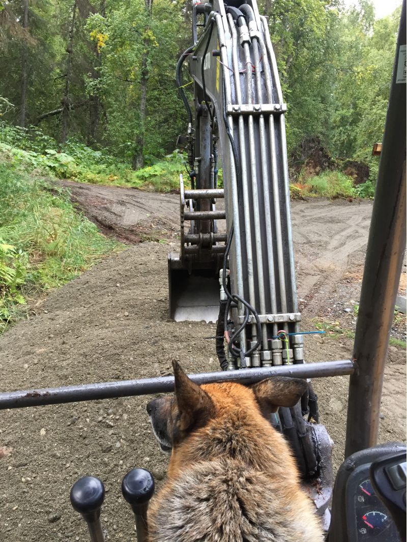

It looks like a great start, probably not much overburden just by judging by the looks of the boulders off the side. I would smooth the dirt/mud so there are no puddles as it looks to be draining to the inside (right of the picture). I would then lay out fabric (geo textile) and gravel with a 3" minus. Put about 10" of that down, then cap it with 1 1/2" crush. The back hoe can do all the work. If you can get your hands on a small wheeled vibratory roller I would roll it. It will lock up the materials. And you won't have to think about your drive way for another 20+ years. IMG_1477_2.JPG

# Posted: 22 Feb 2019 12:58pm
That's a pretty talented dog AKfisher!

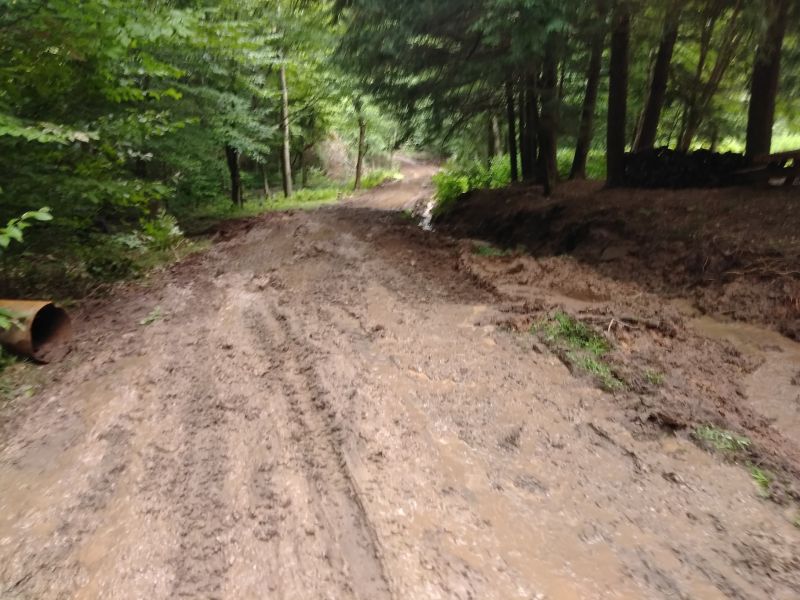

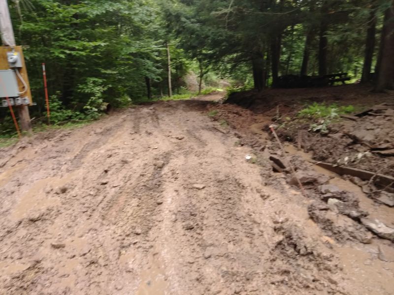

# Posted: 24 Feb 2019 08:37am

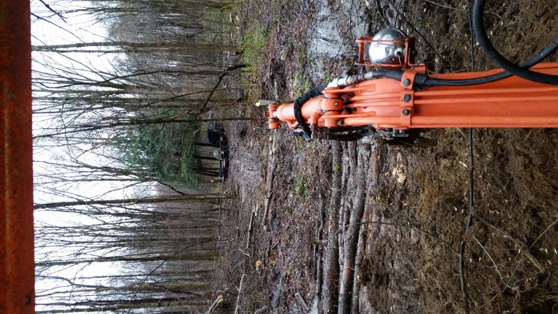

I have a job this summer. The rains in PA have been unforgiving. Cabin_demo10.jpg

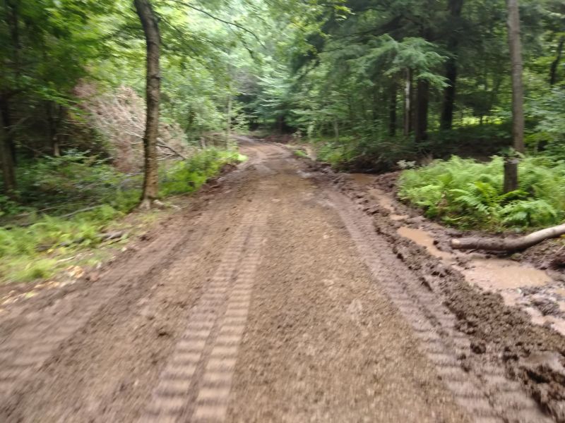

I woukd expect they say limestone due to its small size. But due to this it can also wash away. Use crushed stone that has the dust alreaty in it. Your correct driveway fabric is no good on slopes.
Im about 75* done with my driveway that part of it was through a swamp. The driveway fabric really helped but ditches and places to run water off helped alot also.
From complete mud pit of a swamp to a hard drivable surface. Theres only roughly 6-8in if stone there. The fine stone is what really locks it in and the driveway fabric dosnt let the mud mix into the stone. 20190426_111749.jpg
