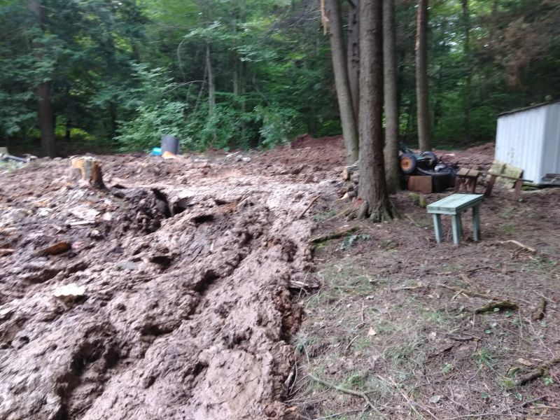

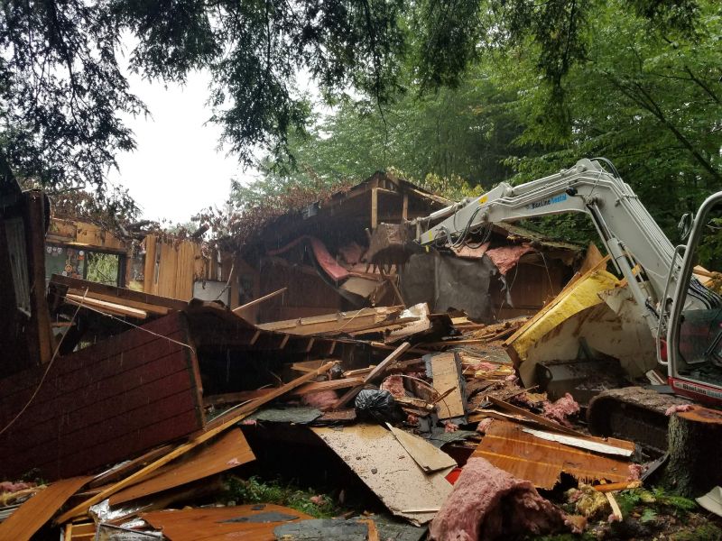

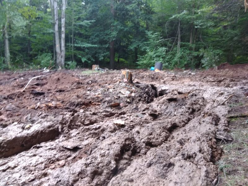

I own property in Northern Pennsylvania. It had a cabin on the property that we had demolished last summer due to several problems including structural issues and black mold. The weather has been less than cooperative for the past year and its safe to say the whole area is soupy. I purchased plans for a 16x36 cabin. My question is what type of foundation is recommended? The ground is sloped. The plans show posts around the perimeter of the decking, but wouldn't pier and beams be better? Cabin_demo15.jpg

Have you had the soil tested? Perhaps a helical screw pile foundation would work.

I would be putting that thing above grade to not repeat the mold problem. Then I would spray foam with closed cell, the floor to make sure no water vapors migrate up.
I did that with my cabin, and it made a noticeable difference in the spring when the ground is wet to prevent the moisture from getting into the cabin.
