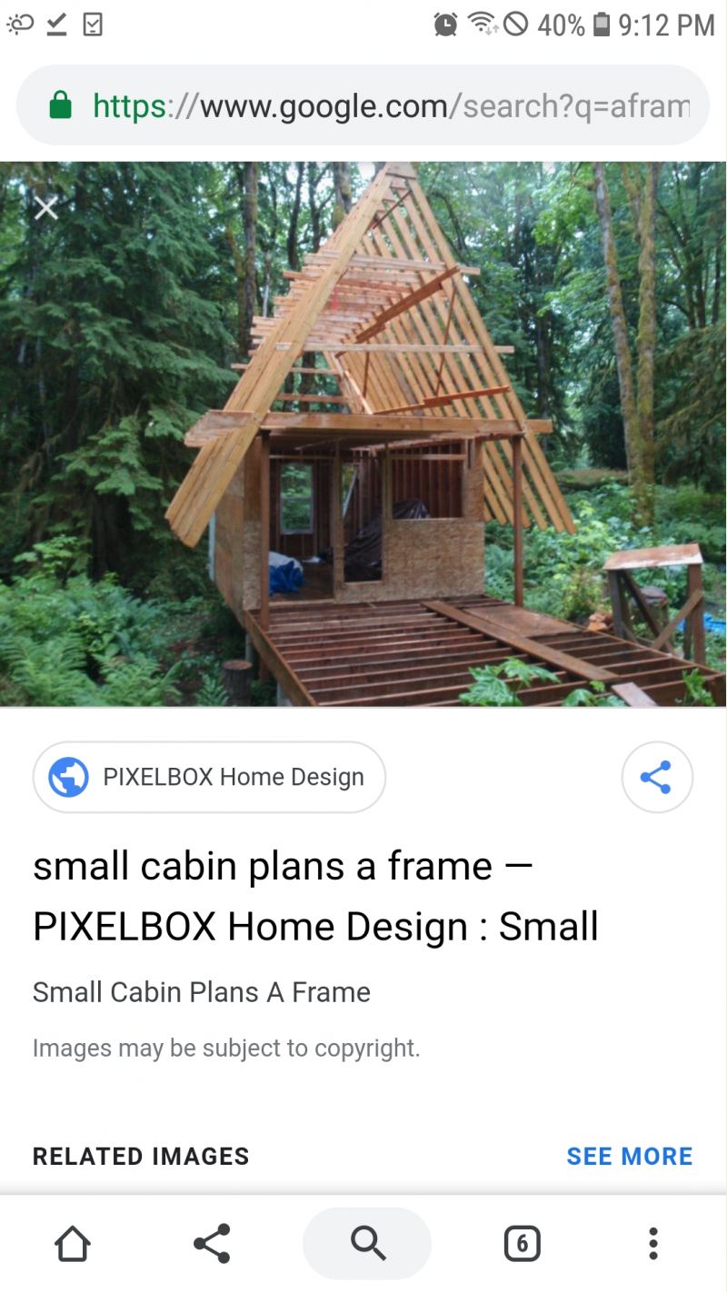

I'd do something like this idea.

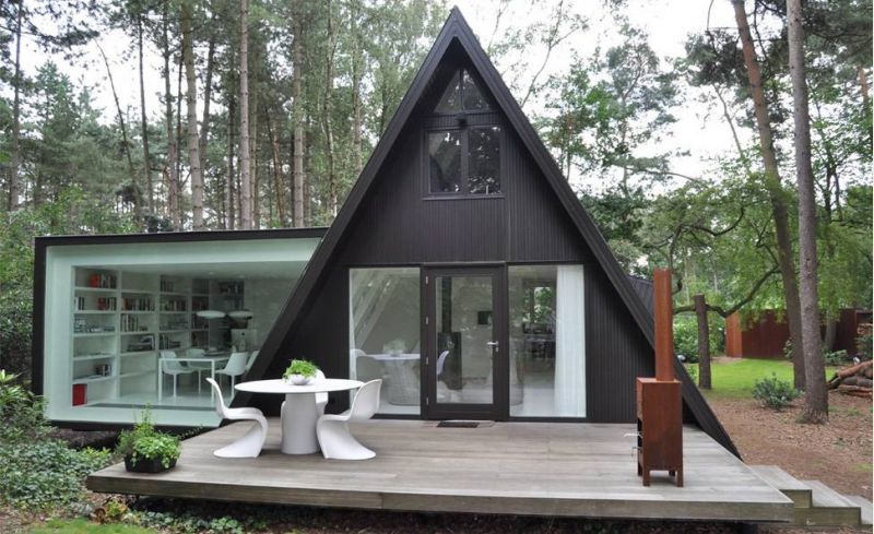

The only A frame I've ever liked was this one.
https://www.trendir.com/modern-glass-house-addition-by-dmva-architecten/
# Posted: 2 Mar 2019 11:14am - Edited by: Aklogcabin
Reply Quote
I like your idea! If you wanted to put a small hip support board twards the bottom you could extend those roof joist even longer and put dry storage there. Maybe depends on how long your sawyer can cut. Metal roof? I like to see the drip line away from the foundation. Looks like you just have a long roof to me. You could also consider digging into a side Hill . Or if you want or are on flat grade, bring in some good draining backfill to support the lower walls ,. If you are going to have a buried septic tank this may help if you have water table issues. This is your dream maybe even family dream. Use common sense and don't let folks make you feel that you can't . My old man told me that there is nothing in this world that you can not do. Own it and have a great time. Your off to a great start !!!!! You decided to build a small cabin . And wise enough to ask questions. Every one here has there own way of doing there best to try to help in their own way. Too cool man .

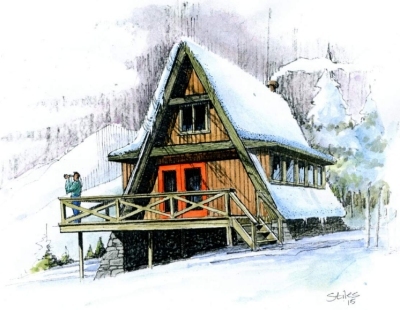

Picking up on a thread from a few months ago, here is an 18' x 24' A-frame by David Stiles (see http://www.stilesdesigns.com/downloadable-shed-plans.html) that uses wing extensions to add light and headroom and reduce some of the wasted space effect of the triangular structure. The main living space is basically end to end between the wing extensions (about 13' 6" x 20') with a small sleeping loft above the kitchen and bath. I was thinking that the "lost" corners could still be used for storage with sliding doors in strategic places.
