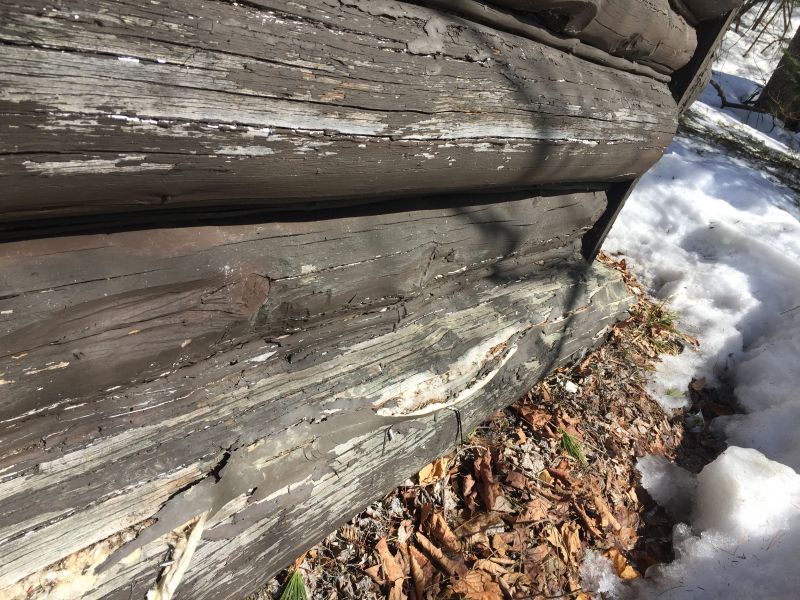

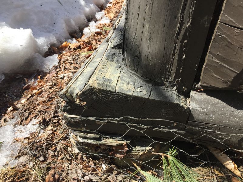

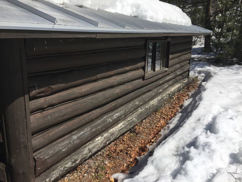

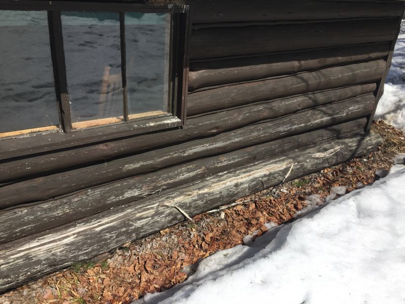

I recently found an old cabin I am extremely interested in making an offer on. I can tell it was well cared for at one time but appears to have been abandoned many years ago. In great shape considering. On the side of the cabin exposed to sun all day, the lower course of logs have lost most of the stain. There are some large cracks that were filled with oakum and caulked at one time. The caulk has since come off. I know it’s hard to tell just by looking but wanted some experienced opinions on the condition and how difficult it would be to replace the logs if needed. I like the cabin and property and this is the only detail making me shy away from it. See photos: Wall 1, Wall 2, Wall3 and Wall 4

Did you have a pick so you could see if the log interior was solid or punky?
Logs that sit on the ground like that are always going to be a problem. I would not want to deal with lower log replacement.
Is the price for land and cabin cheap? Maybe disassemble and rebuild on a good concrete foundation? A friend of mine did that with two old log cabins. Dismantled two, kept all the good logs and made one new cabin.

Drilling a core sample into the logs or using a screw driver to pick at them to see if they are punky is your best bet. From the looks in the picture they don't look too bad, but... That doesn't mean squat. If they turn out to be in good condition there are remedies to keep them that way: Longer eve, penetrating oils, crack filler with rot prevention etc...
If they are bad or half bad there are ways to fix them. Just takes time and money.

Thanks all for the replies. The Martins cabin videos have challenged my manhood. I’m going up to look at it again tomorrow and will take a screwdriver to pick at the logs. Sounds like it’s doable to replace the logs if need be for sure.
