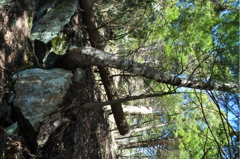

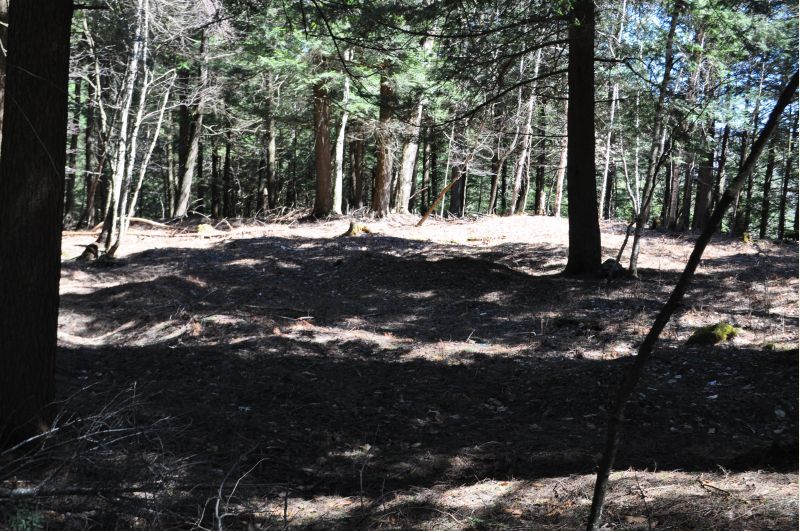

So I was looking at a property in Northern VT, it is slopped and the soil reports show its pretty much all bedrock, the property is pretty much a small mountain.
There are 2 somewhat level (about 10% slope) spots perfect for a cabin. Both of these spots are bedrock protruding from the ground. My question is what are options for building on that?
