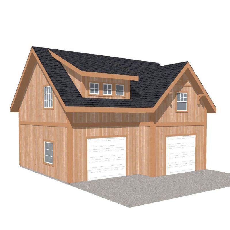

If this is a building that will remain for the duration, you may want to ponder a concrete slab (pending on location, frost protected slab with radiant PEX imbedded) and is not as expensive as many think. Then you could go for a suitable size and a "Packaged Garage Kit" which you mod into a cabin by replacing one garage door with a Window, other with a "man door".
An example image @ Bottom from HomeDepot USA (just a random find). There is a huge amount of options and that one is 2x6@16oc construction, could be adapted very nicely.
I built my place with Radiant Heat in the slab & for my location, that is a real god send ! Cheap as borscht for heating too but the rest of the build accounts for that. HINDSIGHT @ 20/20 It would have been easier if I had used such a "garage kit" and TBH probably would have been cheaper, although I would have still used the foam insulations.
My place is 20x20 and the FPSF Slab (8"thick & wide perimeter, 4" thick cross section, rebar & mesh) cost me just under 3500. I supplied 4" HD-XPS Insulation to go under it and the 7/8 Radiant Pex from the The Radiant Company
Home depot.com Barn-Pros-2-Car-30-ft-x-28-ft Engineered-Permit-Ready-Gar age-Kit-with-Loft (Installation-Not-Included)
Home Depot Garage Kit example
I really like living quarters above a garage or workspace. Like the idea so much that is what I did. Concrete slab and concrete block ground floor walls. Then a cement fiber clad wood framed second story. Metal fire rated overhead doors on the ground floor shop.
