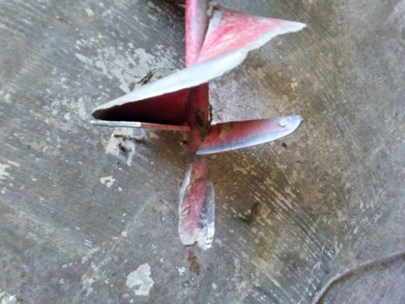

I borrowed a gas hole digger to build a fence. Dug a couple of holes but it wasn't really cutting it. Wondering what I can do sharpen this, or do I need to replace the bolt on blade?

Blade is dull, auger is damaged, its worn out
# Posted: 5 May 2019 08:50pm
A new tip may only cost you $25 to $35.
The blades can be sharpened multiple times.

# Posted: 5 May 2019 09:50pm
New bit time

If that’s the case it may be cheaper to just go rent an auger.
# Posted: 9 May 2019 02:43pm
Upon closer inspection I realized the removable blade had been worn such that the trailing edge was lower than the leading (sharpened) edge. By grinding back the trailing edge and sharpening I was able to bore my next hole easily. Only about 6 more to go..
