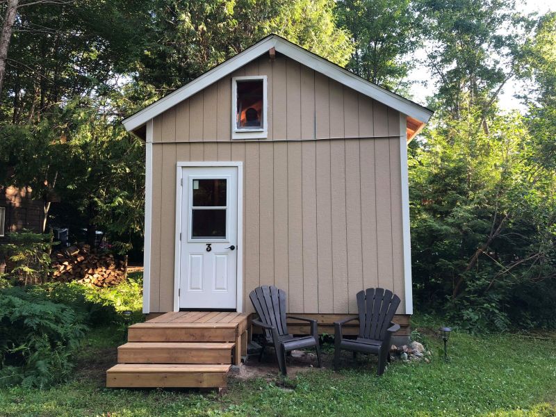

Klick on my member tag “just†to the right ,then klick on 7 day build .I did it for 3500$ in2017 .good luck
