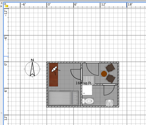

# Posted: 20 Jun 2019 07:23pm
I'd recommend downloading (http://www.sweethome3d.com/) you can play with layouts and try different options (and its free). I played with your original 10x16 layout and came up with this option as an idea, but there are many options you didn't include. I chose twin xl size beds, and a shower/toilet/sink, but I'm not sure what your needs are. In this layout, there is wasted space in the bunkroom that I added a dresser to take up some slack, but again, without more info I wasn't sure what you are dealing with. I chose a standard small bath layout of 5x8, and that leaves you a small space for 2 small chairs and a small table for a living space. There are many better options but this might help you visual the space.

# Posted: 20 Jun 2019 07:38pm
Tiny house is what I am going for I think, without a kitchen, it does not have to be 10x16 that is just what I thought would be good. If you have better ideas for a tinyhouse/bunkie layout I would love to hear from people who have built already?
I know eventually I will be building a much bigger cabin, but right now I want to build something that is just enough for 2 adults. Once the bigger cabin is done, then this building would be just for guests to sleep.
