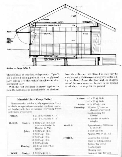

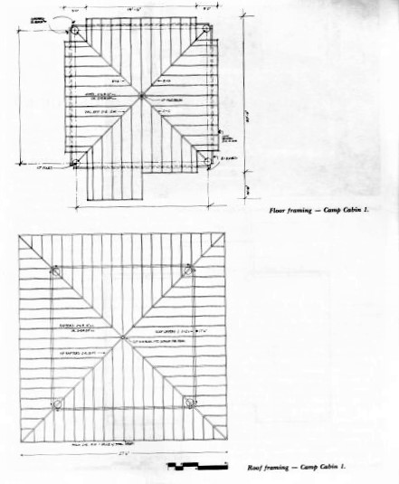

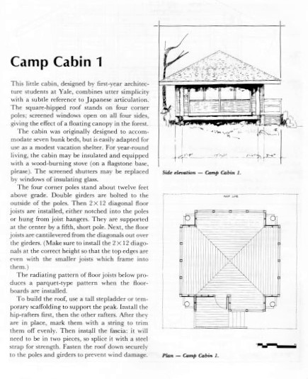

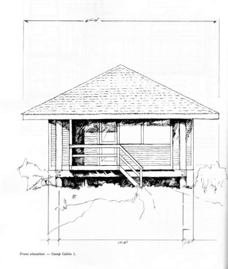

One of my favorite DIY home/cabin books is Low-Cost Pole Building Construction by Ralph Wolfe. I have always like the elegant simplicity of this Japanese-inspired pole construction cabin original intended as a bunkhouse for 14 people (7 bunk beds around the perimeter) using just four main and one center poles. I think it would make a great, simple cabin, maybe setting up the bathroom in the alcove by the entrance and using the rest like a studio apartment. It would need insulation and windows and a heat source, of course, in all but the warmest climate, and maybe a deck and sliding glass door opposite the entrance. What do folks think? Cheers, Matthew Pole Cabin 1

Hi, when I try to view the images, I can't read what the overall dimensions are. What is the size of the main "square" area that makes up the cabin?

This reminds me of a very nice cabin in BC Canada which is only 280 sq'. The central square is 10 x 10' with 6x10 bumpouts on three sides and a 2x10' bumpout on the entry side.

I don't have the original book with me since I am in the middle of moving, but the floor girders joining the posts are 18' long so the single room is about 18' x 18' on the interior minus the corners and the entryway, so call it about 300 sq ft.

On this this little pole cabin design, I could see a little stove like a Fatsco Tiny Tot on a flagstone base right in the center.
I am of two minds about the "cut out" that gives up interior space to extend the front door landing as it's already tiny inside but I could see a couple of chairs on the landing working well.
A little bathroom on one of the corners could work, one side making an alcove for a composting toilet and the other side an alcove for a simple shower with a tiny sink (stainless bowl) on the inside corner, perhaps with running water but no hot water (heat on stove).
Just a single burner propane stove (plus the wood stove) for cooling, little kitchen sink, top-loading icebox (cooler with added insulation), and a minimal solar system for 12v lights and electronics. I am still kicking around ideas for the rest of the layout but bunk beds and/or a college-style loft bed could work well. Hmmm.....
