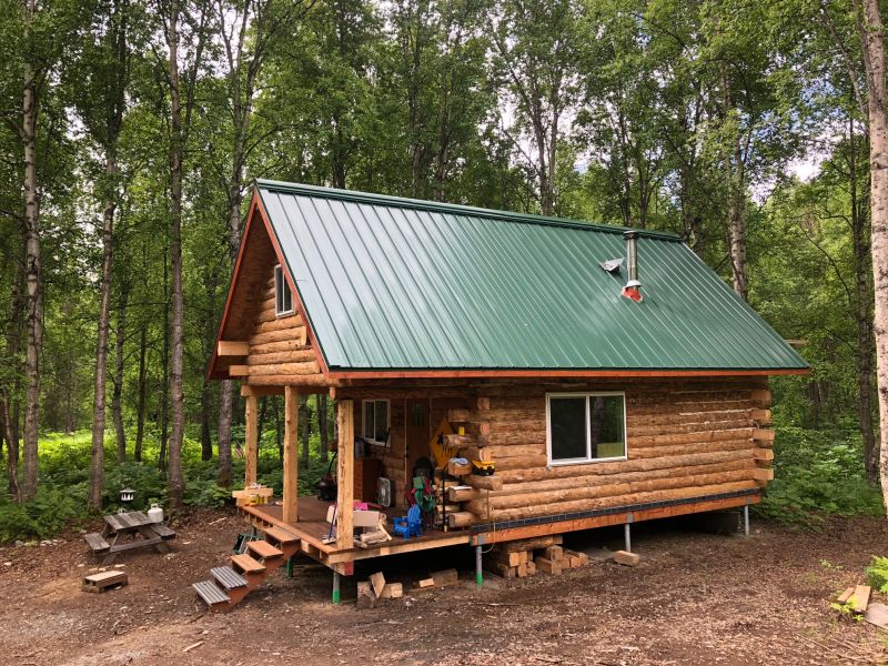

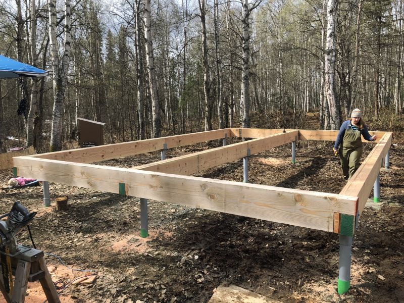

I priced out doing sonotubes by myself. Once you factor in the skidsteer rental to dig the holes (12" sonotubes) buy the sonotubes ( I was going to do 6' deep with 2' above grade), rebar cages, mixer truck, finishing work. The price vs screw piles wasn't much. I called a helical pier company, they showed up and installed all the piers in one day and were gone.
12 piers, 16'x24 cabin with 8' porch.
The cabin has been through a 7.0 earthquake, and lots of after shocks.
16x24
16x24
cabin
cabin
