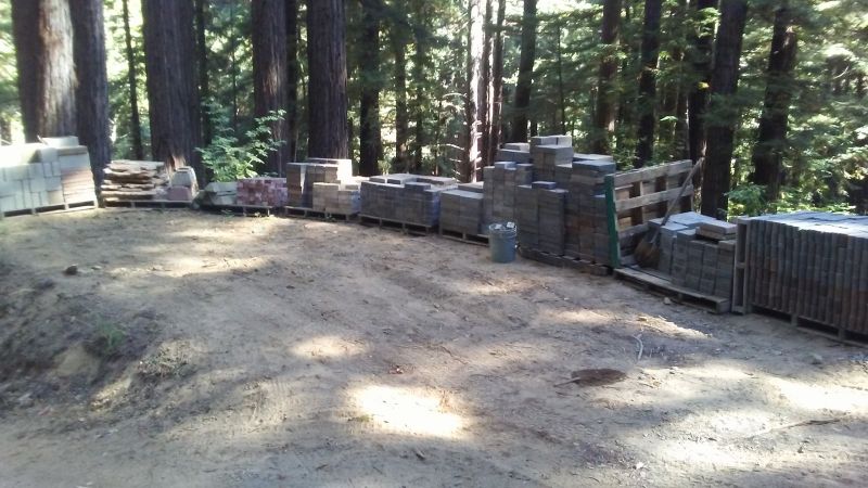

Anybody experienced with pavers? A local guy retired and gave me all his leftover inventory. Many, many pavers, about 1/3 of which are pictured. So I am going to put them in the parking area at my cabin.
Couple things: I have three different colors and two sizes. The rectangular ones are 1.5 times longer than wide, so two equals the length of three squares ones. Not really sure how many of each I have, seems like plenty. Do I try and make some sort of pattern or just mix it up?
And for the different colors, I could do all one color for 1/3, then switch and switch again. Or I could do stripes? Or again just mix it all up? 0626190818_HDR.jpg

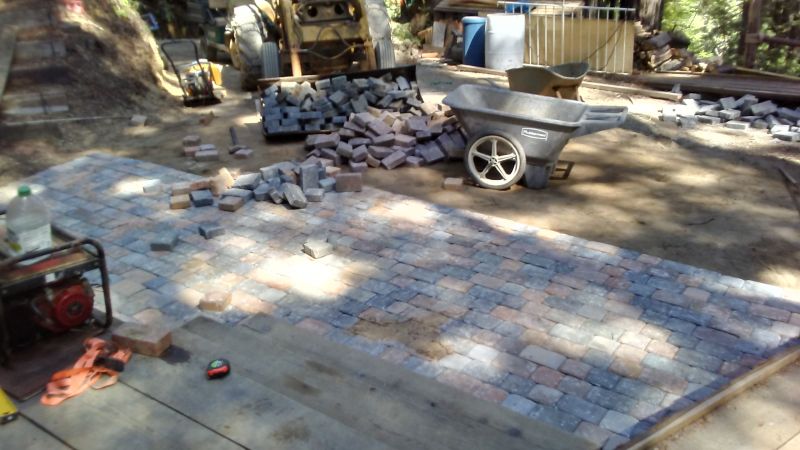

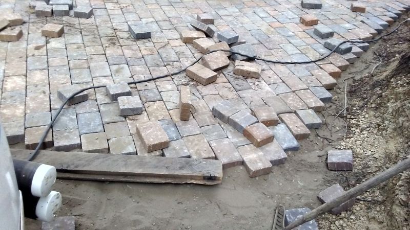

Geez this is a lotta work. Yeah I've just been mixing them up. The sand I got from the the gravel place is fine, I heard coarse was better but that's what the guy said would work. About halfway done. Definitely an armature job but it beats dirt. Taking today off to rest my back and hands. Maybe even tomorrow.
# Posted: 2 Jul 2019 04:22pm
Hey, that looks good, the absolute perfect shtick lacks personality & character. The way your mixing the colours & sizes looks much more old world and tough.

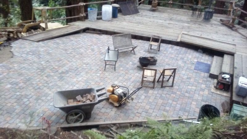

Never realized how big my parking area was until I crawled over it inch by inch. Almost done, and only 1-2 pallets left, should be just right. Learned a couple things along the way:
1. If someone offers you free pavers, run away. Pour concrete.
2. Like most projects, it's all in the prep. I watched some videos on screeding the sand but I should have done a much better job of it. So I have some high and low spots. The tamper knocks down the high spots pretty well, have to pull pavers and fix the low spots. But I figure a winter of parking my truck there will be more to fix, so going to give it until then.

# Posted: 15 Jul 2019 05:01pm
That looks great!

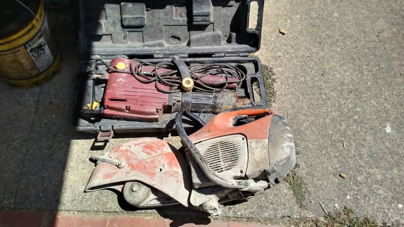

So I went over to my friend that gave me the pavers yard, remembered seeing this in the weeds. Stihl TS420 concrete saw and what looks like an electric jack hammer. The saw had a broken pull start, then it looks like someone tossed it off a truck, bent handle bar and broken saw arm. I fixed the pull starter, cleaned the plug, fresh gas and boom, purrs like a kitten. Ordered a new arm off Ebay for $50, looks like this is an expensive saw. Got a couple of blades that are probably shot. So it will be a bit before I get to try cutting pavers.
