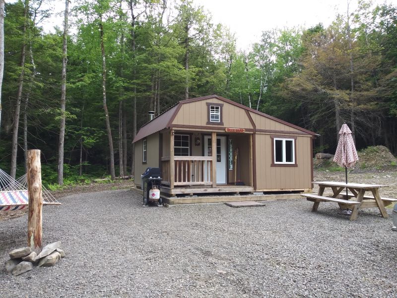

I used 6x6 for the border and filled it with rock. Compacted it and it has been sitting like this for 2 years now. The drainage is very good, the border is raised a bit off the ground on the sloping side so the water can drain better. I do get a little frost heave in the winter but nothing to bad.

I feel I should point out something though... xtolekbananx photo and his install works for a building on "Skids" which is not physically anchored to anything but rather sitting on the pads and therefore can & will float a bit. With your desire to anchor it, the approach is slightly different and you have to plan for that difference.
