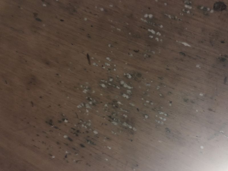

We just had a 16x20 cabin built in southern Vermont. It is 4 season, so insulted and has vapor barrier. It was completed late April. We visited in the end of May and end of June with no issues. Came back today for the weekend and the entire floor (still plywood) is covered in green/black mood and white powdery mold. The window sills and gram around windows have it as well. The builder is at a loss and has never ever had this happen. Everything was wrapped and insulated appropriately, we are assuming. It’s been HOT and humid here but that shouldn’t cause a properly sealed cabin to have this happen. He said possibly the wood that was delivered was moist? We are meeting him at the cabin in the morning so he can see it but unsure what or how to remedy. Currently at a hotel because it cannot be safe to breathe in for us or our small children and dog. Any insight would be appreciated.

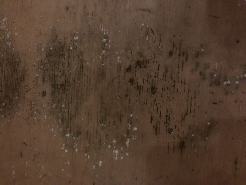

# Posted: 27 Jul 2019 07:19am
No electric. We are at a local hotel so I only have 1-2 photos from last night with no lighting. This is what’s covering the entire floor and some planks of the wall and window sills.
# Posted: 27 Jul 2019 08:40am
do you have any ventilation, or was it sealed up with all the moisture you introduced during your last visit and left in the hot weather.
Ventilation is the key, or moisture builds up and moisture equals mold.
I would get some windows open first, then figure out your options, but if its closed up that mold will keep growing.
Sorry this happened to you, but good luck. Perhaps best to speak to a mold expert

Yeah, odds are it rained during the build or wood was wet. Then the building got dried in and wraped up tight. Damp is still in the wood and add heat... mold.
I would clean with bleach solution and at least get fans blowing on it to help dry it out. The best would to put a dehumidifier in there to dry it out. If not any power you can put down a layer of cat litter to help dry it to start, then a few shoe boxes full till it gets drier.

Get a moisture meter so you can see what the moisture content is. Construction lumber should be 9 to 14% max. Wood flooring should be 6 to 8 % max. Wood that is 20% or higher readily supports mold growth. Also if the moisture level is higher than 15% or so you may have problems with paint not adhering properly.
Common bleach is not the best product to kill mold on wood. The chemical structure of bleach makes it unable to penetrate porous surfaces like drywall or wood. So the surface mold is killed but the roots are left behind. If the wood is still too moist the mold can regrow. Bleach is great on hard nonporous surfaces.
