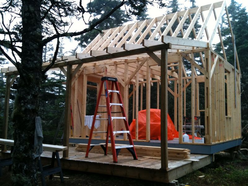

To frame my 12x16 (with 8x16 covered porch) cost me about $2400 CAD in 2010. Thats lumber only. No foundation, doors, windows, roofing etc., just the 2x4 frame and sheathing. This plus sheathing = $2400
