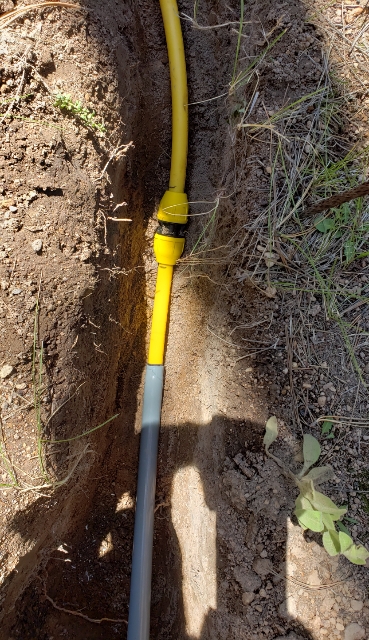

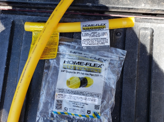

I helped a friend run a new propane supply line using Home-Flex brand poly pipe and fittings. Several years ago we ran a 3/4" black iron line coated for underground use, to the same outbuilding. That was many pieces of threaded iron plus assorted fittings; some 45 and 90 degree elbows and straight couplers.
Today we dug the trench by hand and installed the one length of 3/4" poly pipe. A coupler fitting at each end us a riser elbow. No other fittings required. We had a 100 foot roll. $45. Two couplers @$21 each and two risers @ $50 each.
I'll attach a couple of pictures if I can. Sometimes I have trouble using the phone for image uploads on low data bandwidth. One will show the coupler and parts bag, the other two the riser ends which provide transition from the buried poly to above ground iron fittings. This poly is rated underground only. My guess is rodents could get a problem as could something sharp or hot.

Here is a link to a HD page showing one of the risers. There are several sizes from the 3/4 we used up to 2"
Your friend has shared a link to a Home Depot product they think you would be interested in seeing:
HOME-FLEX 1 in. IPS Poly to 1 in. MIP Underground Meter Riser Bent https://www.homedepot.com/p/HOME-FLEX-1-in-IPS-Poly-to-1-in-MIP-Underground-Meter-Ris er-Bent-18-440-010/300867551
Easy stuff to work with and nice not having so many intermediate couplers and elbows. We had a curvy path to follow
