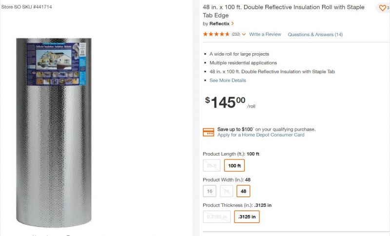

Gcrank1.... likely Boss of the Swamp, he swears by reflextix mylar/plastic bubble wrap. Similar to the stuff you put in your windshield in the summer. I thought about it but opted for closed cell foam.

Looks like HD sells Reflectix. And the install manual says you staple it to the bottom of the floor joist. That would be simple enough but I wonder how much it would do.
https://images.homedepot-static.com/catalog/pdfImages/22/2200e01c-6b38-4def-a59d-05e9 5e8e7696.pdf
https://www.homedepot.com/p/Reflectix-48-in-x-100-ft-Double-Reflective-Insulation-Rol l-with-Staple-Tab-Edge-ST48100/202851852?source=shoppingads&locale=en-US&mtc=Shopping -VF-F_D22-G-D22-22_4_INSULATION-Generic-NA-Feed-PLA-NA-NA-INSULATION_GeneralInsulatio n&cm_mmc=Shopping-VF-F_D22-G-D22-22_4_INSULATION-Generic-NA-Feed-PLA-NA-NA-INSULATION _GeneralInsulation-71700000033102370-58700003867202295-92700048704098360&gclid=CjwKCA iAv4n9BRA9EiwA30WND--nkTby-YTspftpIxmhxNXd6_cdnLWQ_MVzCKzsrQlJqoEpqORgihoCnSYQAvD_BwE &gclsrc=aw.ds
# Posted: 5 Nov 2020 08:46am
I know Boss of the Swamp swears by it, and I think in new construction over the joists before putting down the decking it might be ok. I just can't wrap my head around how bubble foil... other than the reflection of heat.... can be a replacement for standard insulation. I would put 3-4" of closed cell foam up against a layer of reflextix... as far as heat transfer goes, I think the foam will win.
It would have been cheaper but labor intensive, as a one armed guy I could not picture myself on my back trying to hold the reflextix up and staple it.... my wife is a worker but not sure I'd ask her to help on a job like that.
