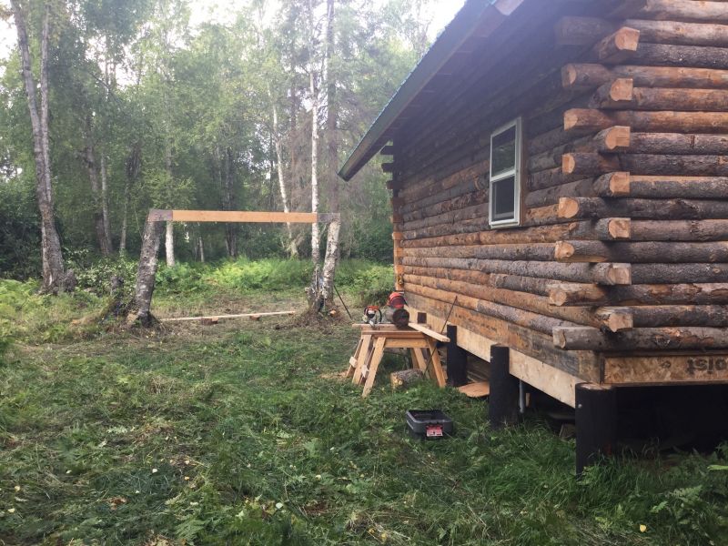

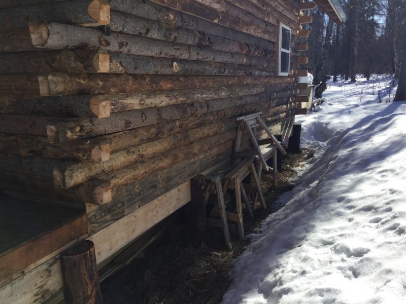

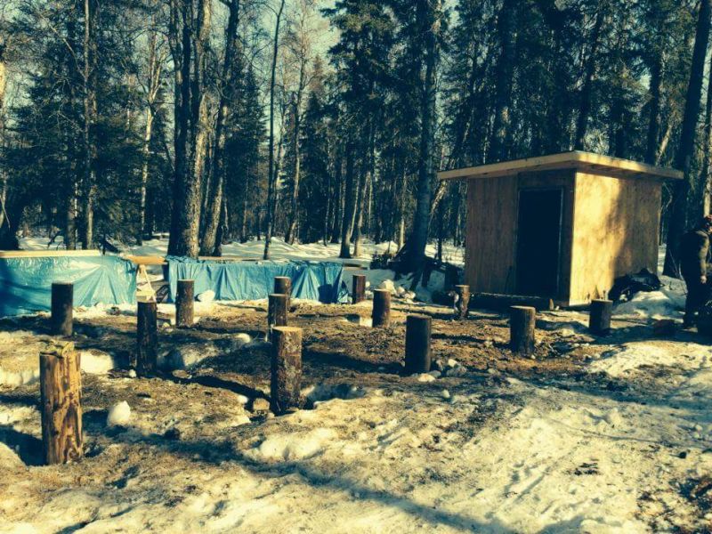

I consistently read posts concerning cabin foundations. For our cabin I stopped by a company that does power line installations. The gave me , free, some utility poles that they replaced. Cedar poles treated so they don’t rot.
These will last a looooong time. And are easy to use. Mine go down 4’ then are about 3’ above grade. Leaving no hinge spot making things stronger. I was able to cut a shoulder into the top of the piling and bolt a 6”x12” to them. A very strong connection. Used galvanized bolts.
You are not building a home for full time dwelling.
A complete concrete footing and cement or block walls is way overbuilding. And expensive. Much easier to pick up the phone and hire out but that ain’t cheap. I don’t have unlimited money to hire out work. And there is only one way to learn. Building a small structure like a cabin is great for learning basics. And I think most of us enjoy the experiences of learning new things that challenge us.
Skids work great for smaller buildings like this. It would be easy to skirt your base to keep critters out.
I also see where folks nailed or screwed 2 bys together. Much stronger and probably cheaper to find a local logger who has a sawmill and get whatever width or thickness beams you need.
Best of luck have fun.
Cabin pilings
Cabin pilings
Pilings connected to beams
Cabin foundation
Cabin foundation

What do you think about the cabin I built?
# Posted: 6 Sep 2019 02:30pm
The cabin looks great. Any interior pics? Did you mill the D shaped logs your self?
# Posted: 6 Sep 2019 03:38pm
Cabin looks quite nice.
