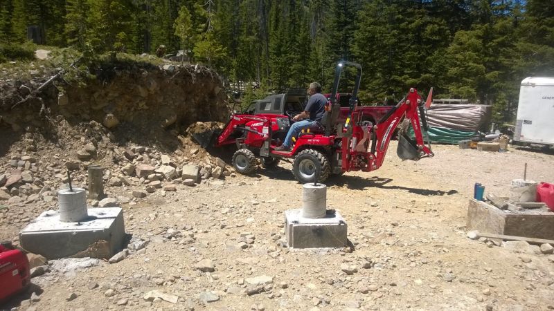

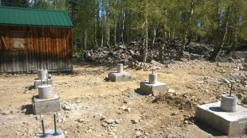

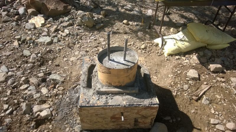

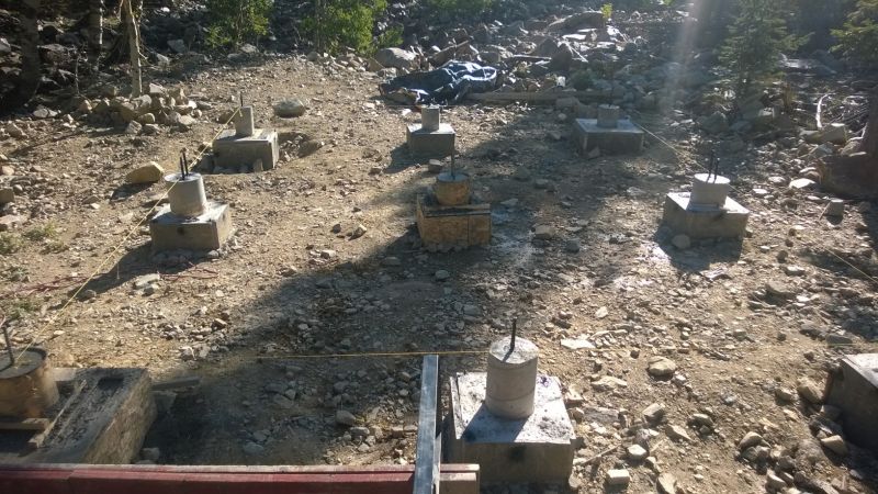

I did exactly what you are planning. I put in sonotubes, but the underlying soil was nothing but rocks. The engineer designed a footing and snotube in one for stability. I even bought a TLB for this purpose. I mixed about 10 bags of concrete for each pier. The cabin has not moved an inch...
