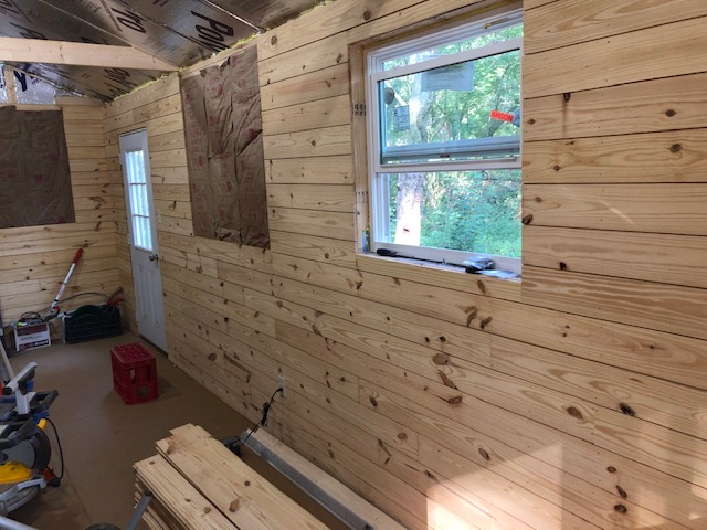

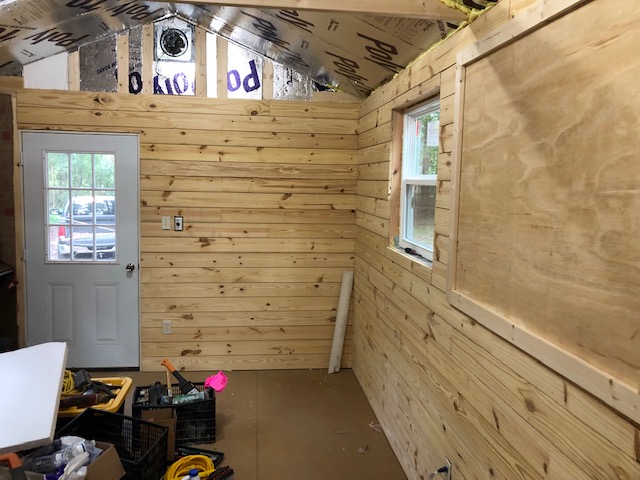

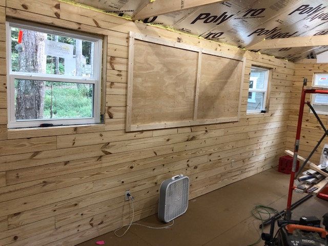

I got the shiplap up in the shed this past week. It's not the most fun 1 man job I have done. I have done T&G in the past on walls and ceilings with no problem. But the price for this shiplap was so cheap (.99 sq ft) that I thought I would try it. These are resaw 2x6 so they have a rough face on them and were a bite curvy. It was a no go on the ceiling- to hard to hold it and line it up and nail it at the same time. Going to just get enough T&G to do ceiling.

Looks really good! Nice work
# Posted: 13 Sep 2019 03:30pm - Edited by: ICC
Looks good. Will that receive a clear coat only or a stain?
Quoting: mj1angier
Commercially produced T&G is often done on a machine that is both a rip saw and a moulder. Put a 2x6 x 16 foot (example) in and it spits out a pair of 1x6 T&G boards. The mill probably has different cutter sets to produce different profiles such as shiplap or T&G without the vee joint. All in one pass with the machine pushing the lumber through. The moulder cuts the profiles and then it is rip sawn. Cool to see. $$$$ to buy.

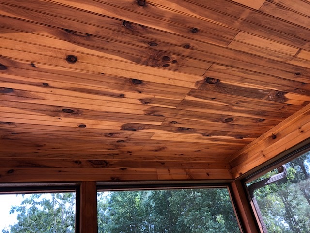

This is our back porch at home that I did T&G on 3 years ago. It was stained with Cabot Australian Timber Oil after I put it up. I have never noticed any non-stained gap from summer to winter- But in North Carolina even our winters are humid ,lol
# Posted: 15 Sep 2019 05:55pm
Yeah, in the SW it is dry and everything seems to shrink
