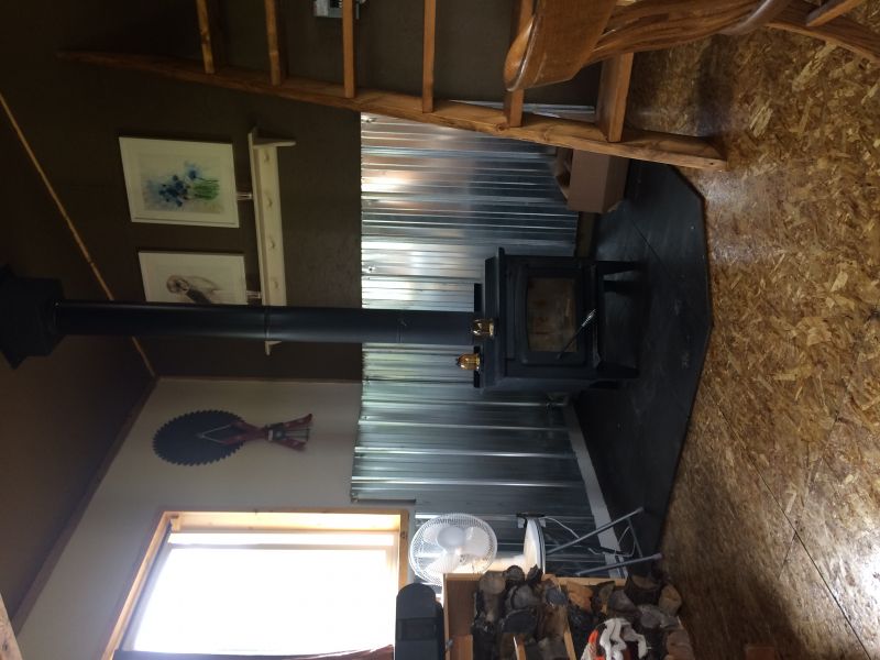

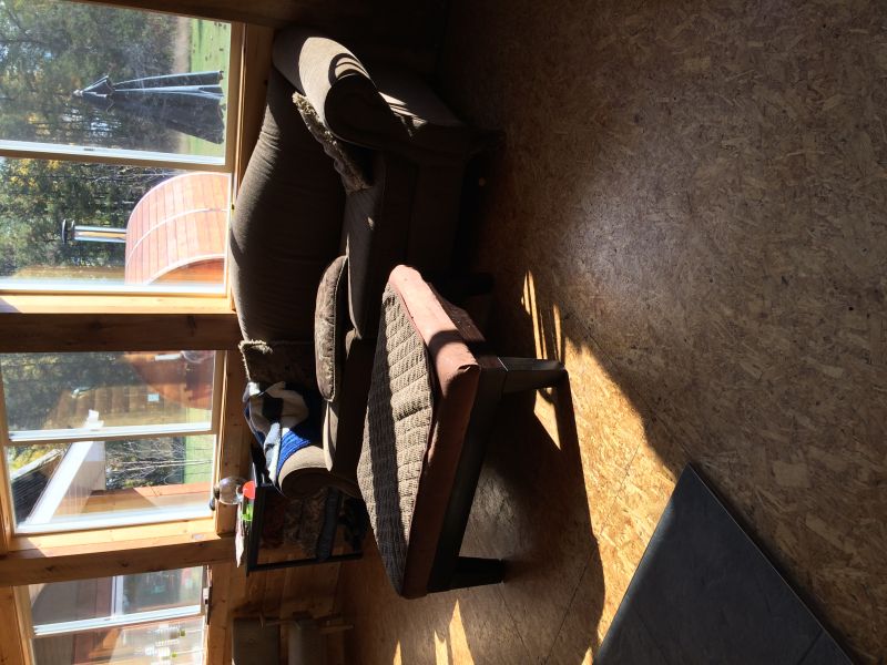

Minwax Fast Dry Poly 3 coats. I sanded the subfloor first.

my sister put minwax poly on plywood floor it its worked fine. I have had it on my cabin floor or 8year and is holding out great! really tough stuff. I have three dog in the house no problem with the finish. if you want to freshen up your floor just add another coat!

I don' see any real downside to using the Minwax product on OSB as long as the OSB is solid and has not got any areas that are flaking loose.
Minwax makes several products with poly in the name. There is a water based finish known as Polycrylic and an oil based finish known as Polyurethane. They both produce durable finishes. I have used mostly the Polycrylic in the past 15 years or so as clean up is easier with just soap and water.
The water based version also dries crystal clear, does not have a yellow color cast like the oil based finish. That is another reason I prefer the water based type. No color change. It has proven itself to be quite durable.
Minwax also sells a product called polyshades, which is an oil based stain and polyurethane protection all in one step.
There is a special version of both the water based and the oil based, made for floors. They are both tougher than the standard.
I have hardwood floors and stair treads using the Polycrylic floor finish in the satin. Various wood surfaces like walls and ceilings have the standard polycrylic. I also used the floor version on the bathroom counter that is a stained alder.
