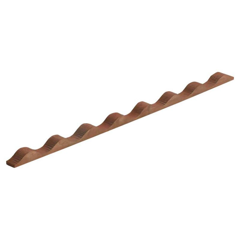

There are corrugated wooden filler strips that sit on top of the walls to close up the ends.

Any place that sells that metal roofing will also have the metal foam strips that match the profile for the holes, will keep bug out, but still kind of breath. It usually have a sticky part that goes under the metal, just stick it on the metal where is aligns with the beam.
