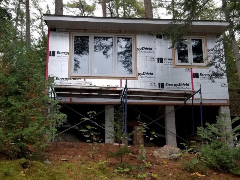

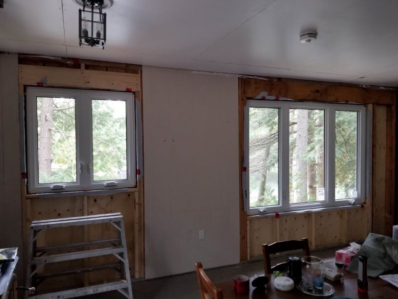

I've been back and forth a dozen time. To install vapour barrier or not, that is the question. I'm now finally getting to the point where I have to decide. I've just put in new windows, new plywood sheathing, exterior foam. I'll be putting on wood siding and finishing the interior with Rockwool insulation and pine T&G paneling.
I've attached a couple of pics. I'd like to hear a few of your expert opinions before finally buttoning up the interior. As always, thanks so much for any help given.
Exterior
Exterior
Interior
Interior
# Posted: 7 Oct 2019 09:06pm
And your location or climate zone is....? That is very important when debating about vapour barriers.
# Posted: 7 Oct 2019 09:17pm - Edited by: ICC
oh, I see your profile lists Ontario as the location. In that case, I believe that means without question that you need a vapour barrier someplace in the wall and ceiling. I also note the mention of exterior foam insulation. That foam can be the vapour barrier IF it is thick enough. If not thick enough the inside face of the foam can be too cold and result in condensation inside the wall. The farther north the thicker the foam. In that case, an interior vapour barrier can be detrimental.

Sorry. Meant to post my location. South-Central Ontario. Been at the cottage at -40C and +40C. So a wide range of temperatures and humidity.

If your using a "breathing" insulation such as Fiberglass, Rockwool, Wool, blown insulation, you will need a 6 Mil Vapour barrier, which should be sealed to the members and with Accoustiseal & tape where the plastic laps.
If you are using Rigid or Sprayed Foam, or another "non-breathable" type of insulation an additional barrier is un-necessary as the material itself becomes the barrier. NOTE: Installing a barrier in such a construction can actually create issues with moulds & mildews. (CMHC has health advisories on that) ** Non Foil-Faced ISO is Breathable, Foil Faced ISO is Not Breathable.
If you are wrapping the exterior of your home with foam panel insulation as many are doing, there are other guidelines to follow to prevent a "Sick House" situation from arising. Sadly, too many were not aware of such issues and have had to effect major work to correct the resulting problems.
BTW: I used Foams extensively in my construction and worked closely with building inspectors here (in Ontario) who had limited familiarity with my type of build so it was a learning experience for them as well.
Keep in mind that the Internet is full of opinions & ideas but always refer to the Local, Regional & National rules, regulations and codes. CMHC as well as NRC have extended detailed info on such issues and should be a baseline reference.
