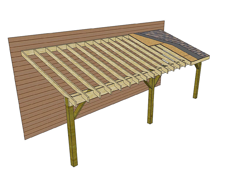

# Posted: 22 Oct 2019 02:12pm
here's is what i'm thinking
lean to
lean to
# Posted: 23 Oct 2019 07:37am
That looks good but i would laminate the top beam together. Having them appart like that dosnt make the other stronger. Your roof rafters also only hit one of the beams if you do it like you show.
Laminate them, through bolt or screw them together and use construction adhesive. Then notch them into the vertical posts. This way your hardware isnt holding the beam up on the 6x6.
sparky30_06
# Posted: 23 Oct 2019 12:50pm
Good point.
