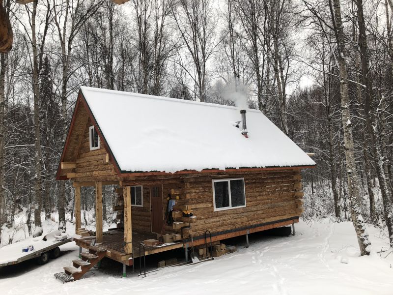

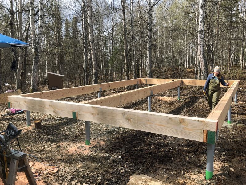

16x24 with an 8' porch/loft. These are helical piers, or screw piles. They are set below frost line. I like to be up about 1-2' off the ground, it helps with snow in the winter time as we get around 6-10' of snow.
Foundation
Foundation
Cabin
Cabin

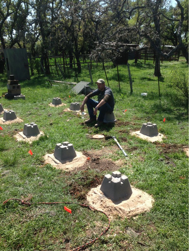

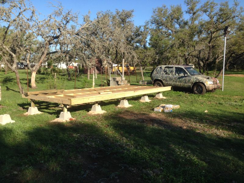

here is the 10 x 20 I built on an elevated skid. Has worked out great for me.
Going 16 to 20 feet wide you will have to size your rafter correctly of get trusses.
I'm getting ready to start planning a 16 x 20 clear span for a buddies lease for a gathering area and planning on using trusses and a similar foundation design.

AKfisher
That is damn near what I am looking to build. Where did you get your plans? More pics?

sparky30_06
Are you worried of the foundation shifting? Looks great.
sparky30_06
# Posted: 30 Oct 2019 06:56am
Quoting: LilGorilla
Don't have to worry about frost in South Texas, eventually it will sink and settle as the ground moves. All the older house are built on pier and beam and need to get leveled every few years. When the time comes I'll get under it with a water level, bottle jack and some shim boards.
i also built it with the idea in mind that if I ever need to move it i can drag it up on a trailer and go.
