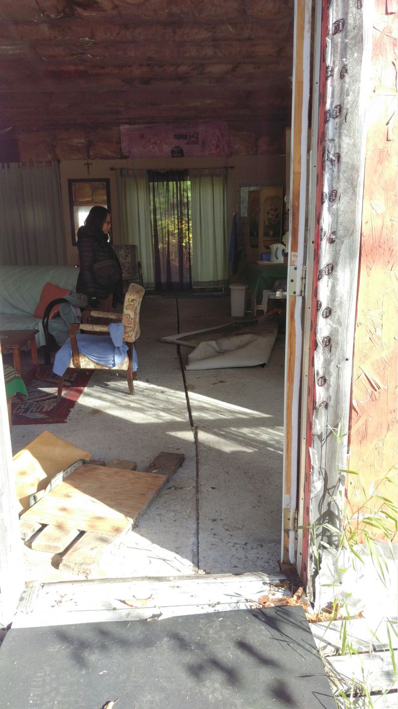

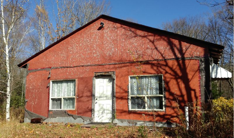

Hey folks! When I last graced this forum, we owned acreage in Haliburton, Ontario with a 8 x 8 bunkie but this summer we flipped that property for a smaller 3 acre lot which included a 29 x 29 converted garage that served as a cabin years ago.
According to the listing agent this cabin needed "some TLC" which I now believe was code for a gallon of gas and a match. The roof is shot, the foundation cracked and there is mold, water damage and the OSB walls are rotting in sections. It also houses several generations of mice.
We initially were set on a complete demo (we have a new RV) and revisit it down the road but after some more thought we decided to make a go of it so we have a place to use in the colder months. We plan to do it in stages as the funds are tight.

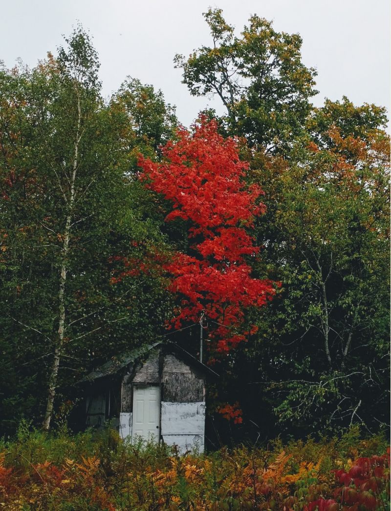

There is good news... - an 8 x 12 shed with electrical panel which has been run underground to the cabin (outlets, overhead lighting and appliances all working) - drilled well - pressure tank and faucet in the cabin - hidden septic tank no one knew anything about (we literally tripped over the cover that was buried in high grass)
So not sure where to start and we are feeling a bit over our heads. I do not have the skills to DIY this as you guys and gals do so I am hoping to get some advice on what we should be aware of as we try to find professional help and end up with something cozy, warm and dry. No bells and whistles required. Some of my current concerns: - is it OK to insulate after the fact or more cost effective to do it at the time of construction? - Recommended wall material? Vinyl siding? - it sits on a 8" concrete pad which is a mess and will be replaced. Should we go with wood or another poured pad? - steel vs regular shingles? Is steel worth the extra cost? - and finally the hail mary pass - if anyone knows someone in the Huntsville ON area that is a carpenter / builder we are all ears
Any insight greatly appreciated.   Frankencabin

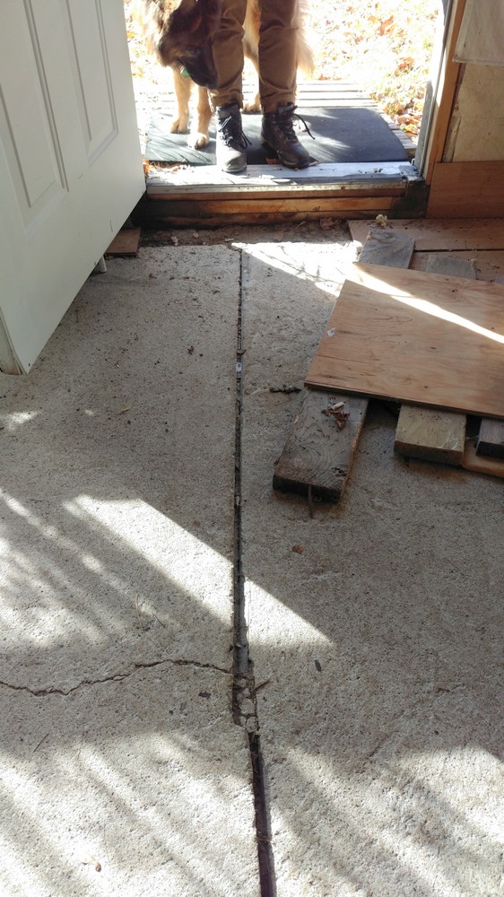

Others more knowledgeable will undoubtedly give more advice but here is my two cents...
Starting with the floor - slab. The large "cracks appear to be poorly executed expansion joints, necessary in a large slab lie that. The lateral crack, well it's a crack in a slab, it happens and not usually a big concern. That said, if the slab is buckling, sinking or rising (frost heave) then it is an issue. Clean the place out then get a good look at the floor.... is it level? Does it look like it is heaving or sinking? If it is indeed an 8" concrete slab that would be a good base for the cabin.
It looks like the cabin is insulated, but if it is rodent infested you might have to tear it all out and start again. YES... insulate at the time of construction...WAY more cost effective.

I think there is some heaving going on here and the advice of a local construction engineer based on pictures we supplied was to tear it up and put in a new foundation. And if that's the case, I wonder if we are better off on piers or another pad? I dug a hole and measured it at 8"

# Posted: 6 Nov 2019 01:55pm
Man you dont DIY and bought that?
Is that built on a slab? If so its a goner. Dont repair over a crumbling slab. Frost heaving usualy means your foundation isnt down below the frost line, again its a goner. Did you have anyone look at this with you that knows much about construction?
OSB for siding will not last no matter how much you paint it.
Im sad to tell you this but this whole place looks like a DIY job gone bad.
# Posted: 6 Nov 2019 02:49pm
If the concrete slab is a mess and needs replacing and there are issues with wall rot, etc. etc. and if you need to pay others to do this repair, it is my opinion you should tear down and build something new.
Extensive repairs, especially with a slab gone bad will cost more than paying for something new. That is if the work is done by someone, a company, that will do things right.
I have been paid to do a few extensive rebuilds over the years. They are always costly and IMO, not worth it unless the property has historical value and/or has family emotional ties. Neither appears to apply to this property.

# Posted: 6 Nov 2019 04:09pm
If the tradesmen actually came out and inspected the place and declared it a total loss.... then it might possibly be. If they just looked at pictures....
Call me an optimist but from the pictures you show of the slab it looks like the expansion joint boards have rotted out or been removed... and it was poorly done. BUT, from those two pictures it would be hard to say if the slab is a loss. I see no crumbling and it is impossible to see if it has heaved or sunk. If it is heaving the cracks and the expansion joints will likely be u even. If the floor is still level, even if it's ugly you still have a base. From just the pictures I wouldn't condemn it. Have you got more pictures of the floor esp areas that concern you?
I would get a home inspector out to look at it... someone with nothing to gain from it being good or bad.

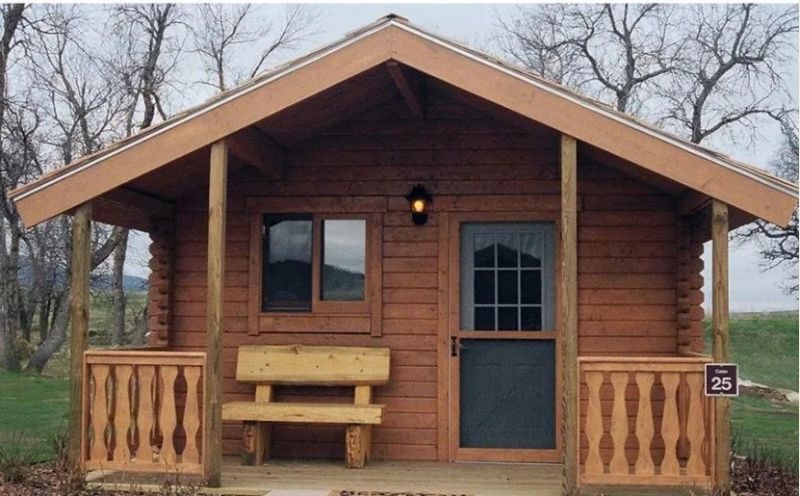

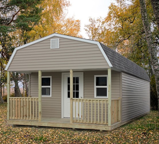

Quoting: Nobadays Not sure what you are thinking when you said... "We prefer the look of cabins with those wood boards but not sure how you insulate them." .... the insulation will be between your studs under the siding/sheathing.
I can see where that would be confusing lol A picture is worth 1000 words so I attached the two styles of finish we are considering. When I see the interior of cabins with the wood siding, they don't appear to be insulated.
Cheers!
# Posted: 6 Nov 2019 05:15pm
The one labeled "wood" looks to be a kit log sort of structure, and no there would likely be no insulation other than that provided by the wood unless it was attached to the inner walls then wallboard of some sort put over it.... losing the log home feel.
The second one looks like traditional framing so would have space between the studs to put insulation, then that covered by your choice of interior wall coverings.... sheetrock, cedar, pine shiplap, paneling, etc.

I used foam tiles on my floor but only in a temporary fashion and i alreaty had them, i also spend next to no time at this place in the winter. No ammount of foam tiles or area rugs will even come close to making the floor as warm as say 1in of foam board under the sub floor.
The second pic is basicly a shed you order and have dropped off at your site. Wright the check and pick a delivery date. Short of making a gravel pad or something for it to sit on thats all you have to do. This may be your best option to tell you the truth. Drop it next to the existing building to share utilities and tear down the old structure as time allows or just use it as a garage until it collapses in by its self.
# Posted: 7 Nov 2019 09:03am
Sheds are not built to live in. If you can’t do the building yourself start getting bids on building a real cabin. You won’t regret getting quality over living in a storage shed.
# Posted: 8 Nov 2019 07:23am
Your right most sheds are not built to live in. The box store shed are real junk. Prety much anything with T1-11 or "smart siding" siding is prob junk also. There aresome real quality portable buildings out there if your willing to look and do the leg work.
