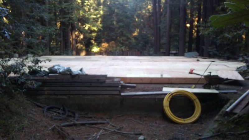

My never ending carport project's roof is in the sheathing stage. It's an almost flat roof, 1/8" per foot. No snow. Big, 35x55 ft. Today I had a roofer come out for a look. He does tar and gravel but apparently now there are alternatives to using gravel. He was honest and said I should look at other alternatives, namely Torch Down and EDPM rubber roof. I may be able to do one of those myself.

# Posted: 12 Nov 2019 08:38am
Thanks guys, looks like EPDM is the stuff, more to follow..
# Posted: 27 Nov 2019 02:57pm
Well the rain came to the west coast yesterday. I'm not finished sheathing my never ending carport project so had to revert to plan B, the ubiquitous blue tarp. Not just any blue tarp, a HUGE one. 50x100. Let me tell you, if you think unfolding and spreading out a 12x16 Costco tarp is a pain... There was one saving grace, once it was out there on the flat surface you could shake it and get some air under it and move it like a giant bed sheet.
Hopefully this gets me through winter and I can get a roof on in the spring. I'm tired.
