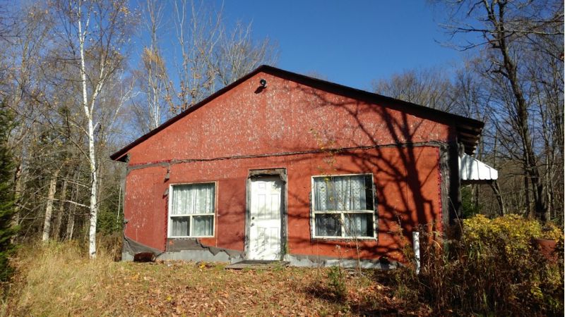

I thought I would kick off a new project thread and ask more specific questions as they come up and hopefully by the end we will have ourselves something cozy, safe and warm. Will add pics as things progress.
Attached is the "before" picture as reference. It is a converted 29x29 garage which we will mostly be tearing down and rebuilding to a 20x20, keeping the original trusses that will leave room for a good sized porch.
So, starting with the existing cement foundation which will be replaced I received a rough estimate yesterday from the cement guy on a 20x20 pad. Gravel base and 5" deep. He said, all in and construction ready around $9K CAD. No insulation or radiant heat (Radiant heat add $3K)
Seems high doesn't it?
After reading a number of threads here I gathered that going with piers would be cheaper and if done properly (insulated, below frost line etc.) would work for us.
So for a 20x20 how many piers should I expect to see in the quote? And 2' above the ground, correct? Will be looking to close it off from bugs and critters underneath and at some point add skirting.

# Posted: 15 Nov 2019 06:09am - Edited by: Steve_S
Yes Piers are cheaper than a slab, obviously a lot less concrete & work but there is a trade off with... year round use and then having to insulate the floor (no fiberglass or anything that holds any moisture at all). I would very seriously reconsider that.
You keep on about those trusses, I have to point out that, that s likely a False Economy when all boiled down. They are used and will likely get some cracks & breaks etc as disassembly progresses. Nail Holes & possible rot / soft spots will be all over. They will all likely need some attention of one sort or another and figure 20-25% loss.
