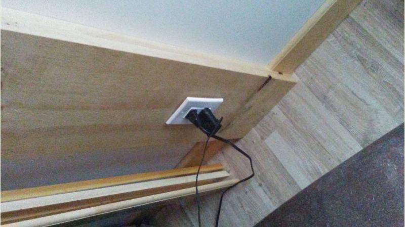

# Posted: 22 Nov 2019 11:21am
I did not put any wires inside my exterior walls, no plumbing either. Where I needed a plug on an exterior wall I used different setups but below is typical.
Using 1" thick rough cut planks in this case with 1"x2" thick strips for the edges, it allowed me to use "shallow" boxes to accommodate the plug. no my cabin has a lot of wood, beams and I made my own casings, baseboards etc so I had a bit more flexibility (albeit labour intensive too). Because I have a "skirt board" running between the walls & ceilings, it provided a good chase to run & secure the wires in prior to covering over with the rough cut planking.
Hope that helps a bit. BTW: I have not read through his whole thread.
