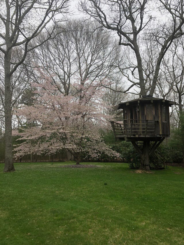

Sprinkler Guy
# Posted: 22 Nov 2019 07:41pm - Edited by: Sprinkler Guy
One of my clients had this tree house built for his kids. The carpenters had a couple of steel brackets made that had a 1” rod drilled through the tree that everything was built off of. It is able to pivot on the rod as the tree sways and has been there for 6-8 years with no sign of failure.
