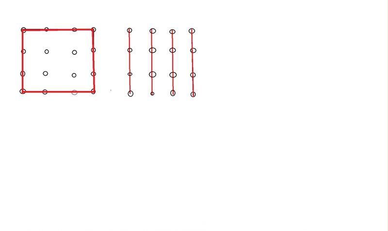

I am building a 30x30 cottage in southeast Oklahoma, Plan on constructing pier and beam foundation. Question is: reference to the built up beams, is it preferable to use built up beams all around perimeter of foundation? (all four sides) In other words, I have seen images of pier and beam construction where the beams only run parallel and I have seen where the beams are forming a square. Please see attached crude image. What are the advantages of the beams running parallel vs. running them all around perimeter. ? thanks for any help here.

I’m not an architect but this is my internet opinion.
You have a square floor plan. Do you plan to use a hip roof so all four of the walls are load-bearing from the roof? If so, then I would think you would want the built up beams to be all the way around the perimeter.
Many of the designs that have beams going only one direction are using a gable roof with the roof line parallel to the foundation beams and perpendicular to the floor joists. Other than cost I don’t believe there’s any negative to running to running the beams all the way around the perimeter. -PeeWee

Peewee is correct but I'd think you'd need atleast a beam in the center to support the floor joists

Peewee is correct. A lot will be determined on how you build your roof.
I have a gable roof and only needed built up beams on the non gable ends. I also put a built up beam in the center.
If hip roof, all sides need built up beams.

Excellent replies, thank you. Yes, I failed to draw the support beams in center for the Joists. No hip roofs. Just a simple rafter or trussed roof. Good info about the gable ends. And you answered another question I had, reference the perpendicularity of the floor joists.

Personally I like the second d pic better. Beams under the floor joists don't rely on hangers. Also if the beams are under the floor joists you can and prob should pull the beams in about 1' from the edge of the building. This helps protect them and makes your span shorter.
In your case being 30' wide you may need 4 beams. I would also price out engineered floor joists/trusses.
You should also notch the vertical posts to accept a good part of the beams.

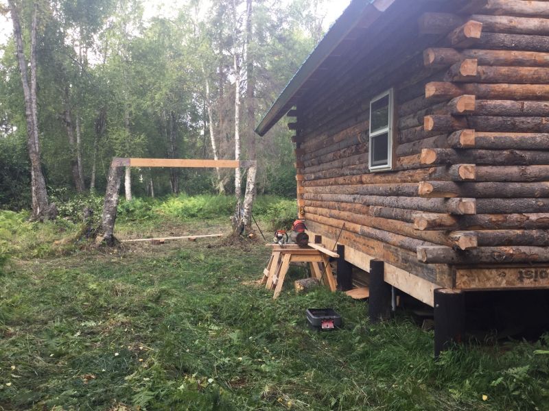

You should place your support beams under your load bearing walls. Do not cantilever your walls out over your support beams. Your floor joist ends and rim joist should both sit on your beam. You have overhang on your roof to protect your building. On our cabin I have 3 feet .
I used 16’ long x almost 12” tall manufactured joist on our cabin. Sat across 3 ea. 4 x 12 beams I got from local sawmill. The cabin size is 16’ x 24’. They have been there for 5 or 6 years now and look brand new.
I used 30’ long x 16” tall for roof joists in my garage to span 24’ with 2 feet overhang on ends.
I have had no movement in my foundation. I used cedar , treated telephone poles I got that were removed from a power line company. I was able to put posts in then level and cut off was chain saw. Then cut a shoulder on post for the 4x12 to sit on . Bolted together with 1/2” galvanized bolts.
Good luck on your build.
Our cabin foundation
