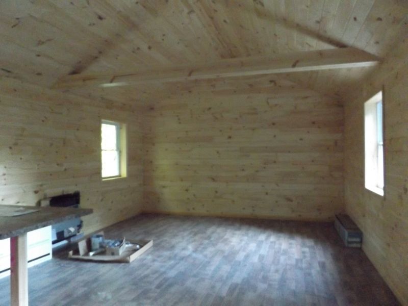

Because heat rises, vaulted will take longer to heat up if you arrive to a cold cabin. For me the look and feel far outweighs this, especially in a smaller (16 X 30 ) like mine. When people come inside for the first time, they always look up.
I've been in small cabins with low, flat ceilings that feel cramped, and cave-like. As always, to each his own!

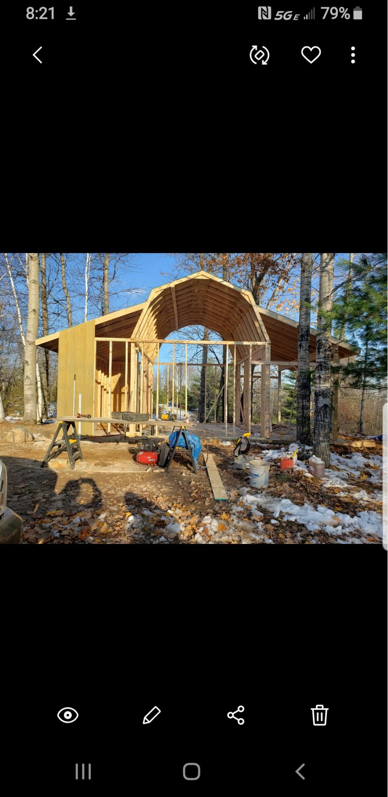

Alternatives to consider (each with pros and cons as per normal) - You could just use rafters either with a ridge board or a ridge beam. I went with a gambrel (barn) roof using a ridge beam then had the roof spray insulated. Cabin is 16x24 with the last 8 ft an upper level overhang loft over a screened in deck. Ridge beam was made from LVLs - originally thought I would need to lift them up one by one but delivery included a crane so easy. A beam needs support through to the foundation so does have a design impact. Added in that I used 10' walls, this provided a huge usable space in the loft(s). The spray insulation (R50) does a great job both summer and winter. Also sprayed the upper ends. Roxul in the other walls. My build thread My Build

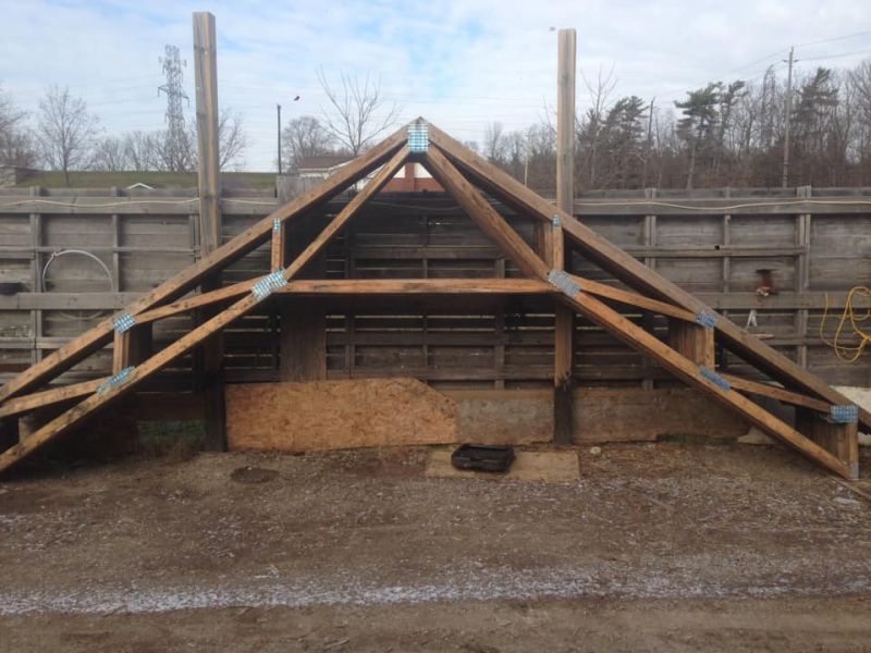

Something like this? These came up for sale in my local FB Marketplace. There's lots of room for insulation and proper ventilation with that design.

Ya that's a good design high but not to high so it's still easy to heat when I first show up in the dead of winter

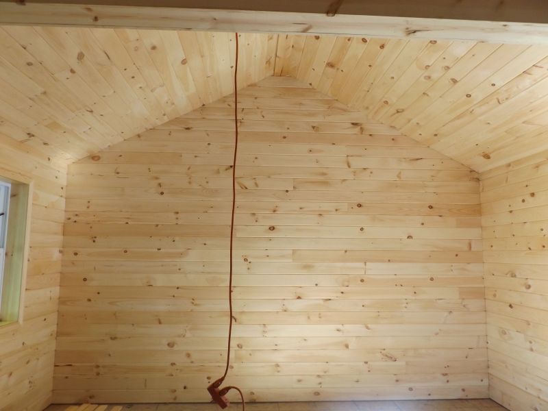

Do the vaulted ceiling. Even if it flat at 9+ft. A little head room makes the whole room feel bigger.
