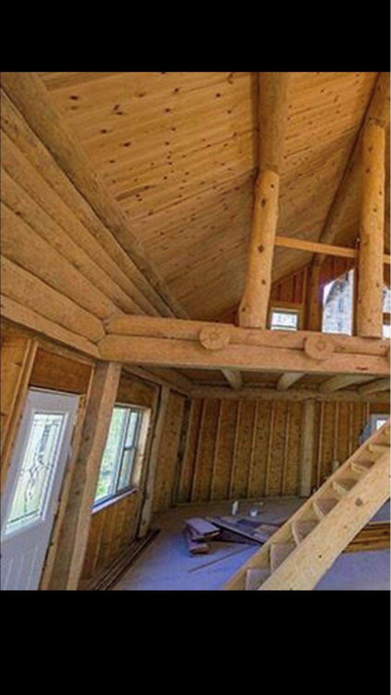

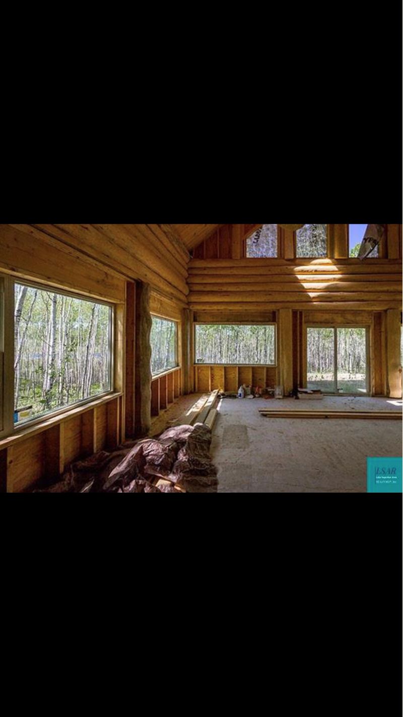

Need framing advice. Just bought a 12 yr old 40x30 half log/half frame cabin that's been sitting unfinished for 12 yrs. It's an empty shell. Slab on grade. The shell is a first floor with 2x6 exterior walls with a 14" log beam every 10 feet to help support weight of logs above. The loft level is a course of 8 horizontal logs, each 12-14". Above those logs it goes back to dimensional framing to the roof line.
I need to frame interior walls. Can I successfully frame standard walls or do I need to make floating walls? The cabin has settled for 12 yrs. Do I still need to be concerned about movement with only 8 logs, and log joists under the loft or can I build them nice and tight from floor to ceiling. Pic attached. Thanks for any input.
# Posted: 9 Jan 2020 09:04am
First off nice place! Beautiful canvas to work with. I can only speak for myself, but as a past log home builder I would not be too worried about settling/shrinkage after 12 years. Saging can happen over time so wondering if that loft cross beam - and that appears well constructed - has support in the middle of the span. That would be my only worry.
My own... first log home was constructed from dead standing lodgepole pine. Since most of the logs were two - three years dead, and the structure was up over a year before we framed out the interior, we fit standard frame walls. That said we did not attach them to the outer log walls, logs move. We lived in that home about 15 years and no problems.
Obviously others may have differing opinions.... Weight them out.
