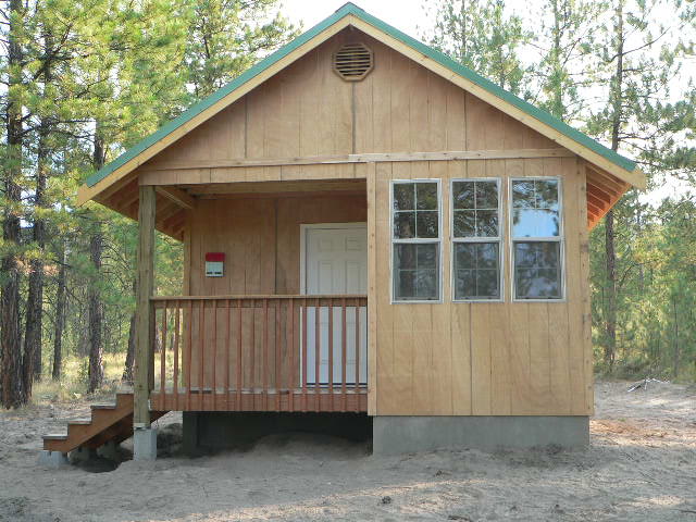

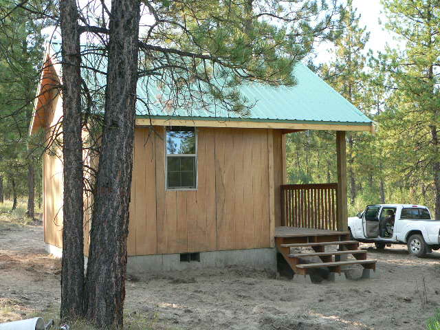

I'd make it, its own. I think water on deck can run to bottom of wall. On mine, its the same level, but deck is attached to rim joist on top of the siding with a gap for water to drain out behind it. No water in or under the wall.
My cabin fits foundation, deck was part of the original design, its covered, part of cabin roof, but totally independent unit, just hooked to cabin. I have a pad and column for roof corner, it secured corner of porch also.
Early pictures during construction.
