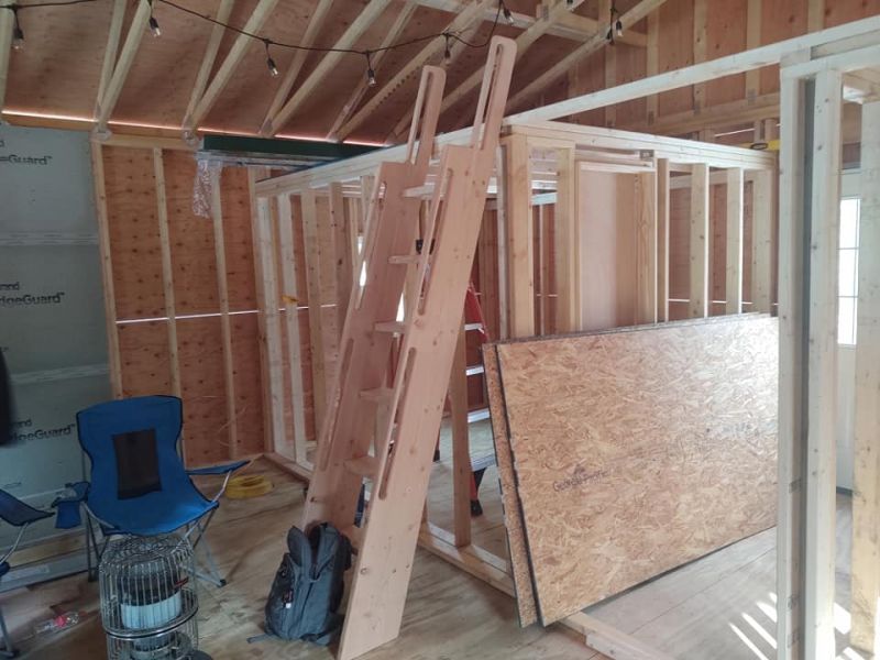

Do you have any pictures of the build yet? I am in the process of a build now. I have a loft on the inside back wall. I think its 8'x24'. I am almost done with the loft but the snow has made me take the winter off. I can't get material to the cabin. Share your layout or some pictures. I enjoy looking at what other people are doing. Especially in the same size cabin as mine. My last build video shows how I put my loft up. But it sounds like your layout is different then mine.
