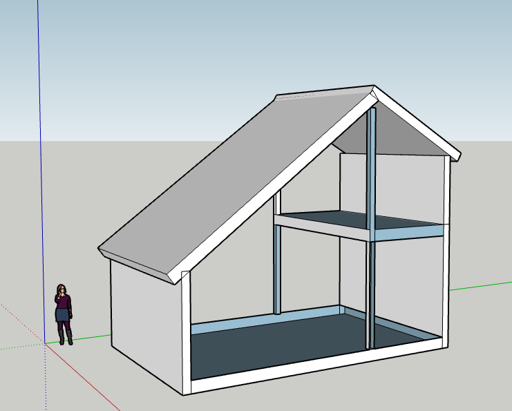

I have attached a pdf of the spreadsheet and a picture of the build shape. Are they viewable/downloadable?
So far I've learned the sheet is missing fascia, exterior siding, coatings, window/door trim, and blocking.

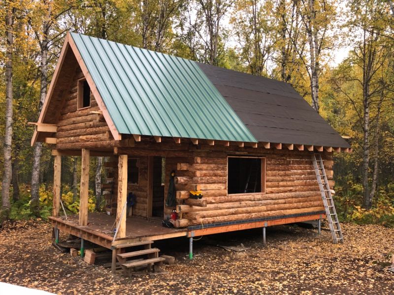

Roof panels with 30# felt

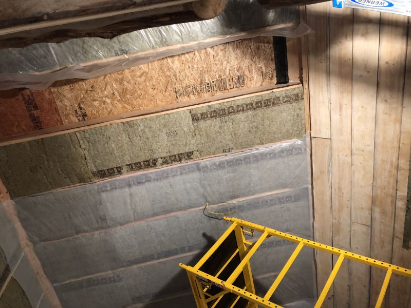

Scaffolding and R30 rockwool

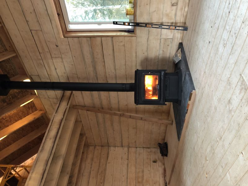

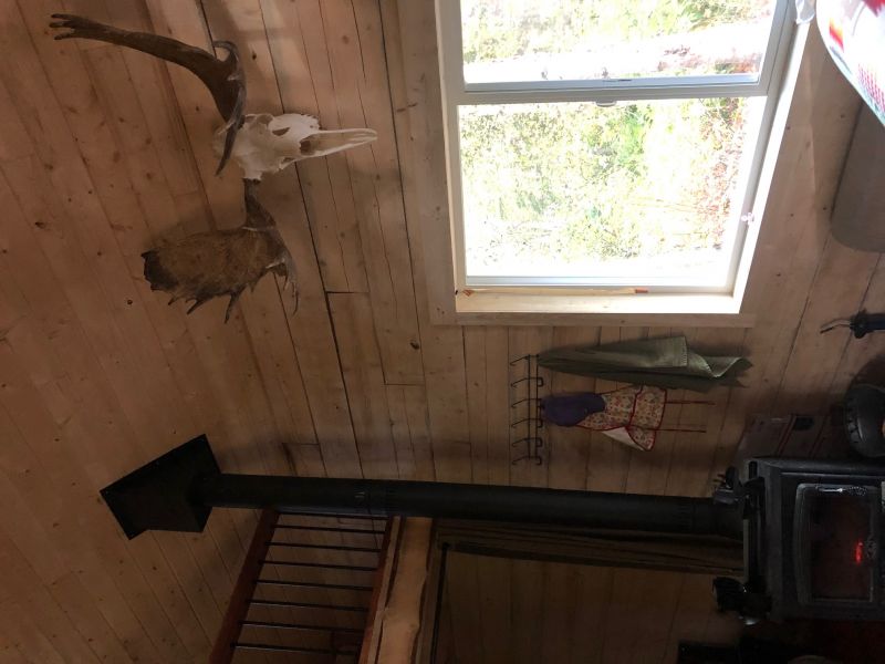

Stove and pipe
Stove and pipe
Stove and Pipe - Finished

That style of cabin your showing OP would work perfectly as a higher pitch roof on the low side and make the loft into a dormer style roof.
You really need to play around with interior layout programs prior to picking an exterior size. I think after you do this you will find that 16ft wide is not wide enough.

@AKfisher, I appreciate the advice. I recalculated the number of metal roofing panels I will need and it looks like it will be 5 21ft panels and 5 6ft panels (both at 36 inches wide). I wasn't sure how to convert that to linear ft via the calculator. I'm also debating switching to shingles, as I hear they work better with solar if I decide to go that route in the future. What's the difference between Bituthene and Ice and Water Shield (or are they the same)? Noted about the gravel spreading and scaffolding. I think I might be able to borrow scaffolding from a neighbor. I'd love a wood stove, but I've also heard wood stoves require regular maintenance of the pipe and are difficult to maintain a consistent temperature. How has your experience with it been?
Brettny, I'm leaning toward no dormer as the roof height would already be 6 ft on the low end of the loft, so the extra height wouldn't really be needed. While I'd love to go wider, every extra 4 ft ups the cost of everything (foundation, subfloor, siding, interior, roofing, etc.).

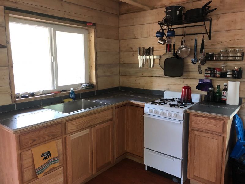

Cabinets, Sink, cook stove can all be found in the classifieds. I bought new as I wasn't going to be waiting around for a deal or a tear out. I tiled the counter myself (inexpensive), actually I did all the work myself. That is the only way I could afford to build the place.
The windows are triple pain, I would advise against them. Great for a home, not great for a cabin. If they frost up on the outside, it is hard to get the windows warm enough to defrost them. I bought those new for around $1000. I didn't want to buy used takeout windows that were a custom size, so I bought new in a standard size. We have two kids, so if one gets broken I can replace easily.
