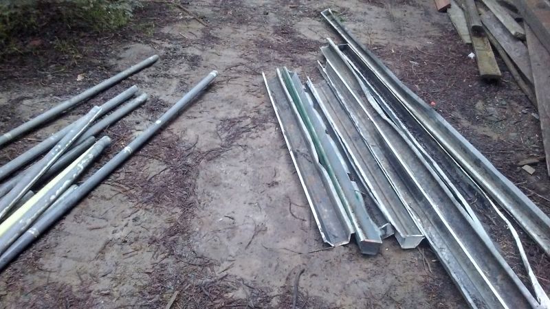

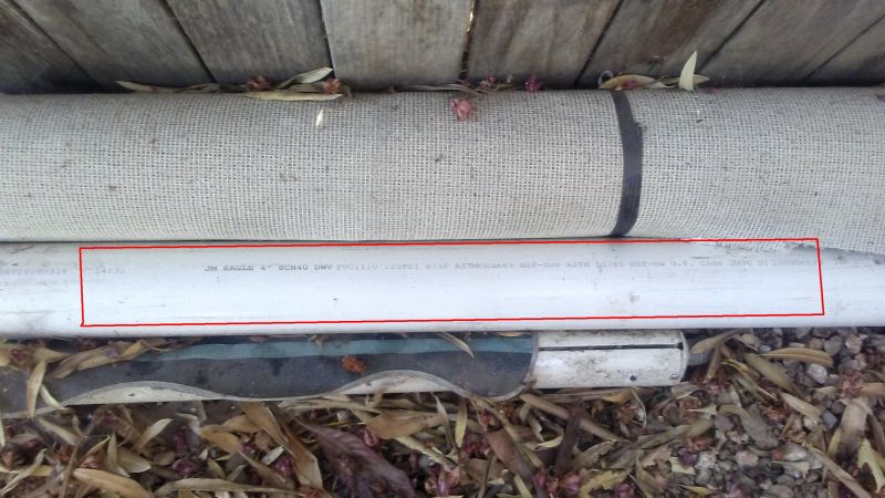

Cleaning up my mess I found these used unrotted metal gutters I have been hanging onto. I haven't put gutters on my cabin yet, probably should. But in my efforts to get through this dang pile of 20' 4" PVC pipe I have I figured maybe I could cut it in half lengthwise, or maybe something less than half, and use that as gutter. Be simple to glue it, belled at one end, and screw it to the fascia board.
Any reason that wouldn't work?

If you used the 4" PVC it would be easy to then feed this into a rain water collection system via easily obtained fittings. The old metal gutters look pretty well used....
# Posted: 6 Feb 2020 06:00pm
Ha, yeah they looked a lot better before walking over them for the last 5 years. Just want to be sure before I pitch 'em.
Good point on the water collection, a tee or elbow and down. Thanks!

This guy made PVC pipe gutters like I'm thinking. I didn't think of slicing them on a table saw though, was thinking skill saw.
https://www.grandmashousediy.com/rain-gutters-pipe/
Funny comments, it's like the guy invented electricity. I guess on the grandmas house site they're easily impressed
