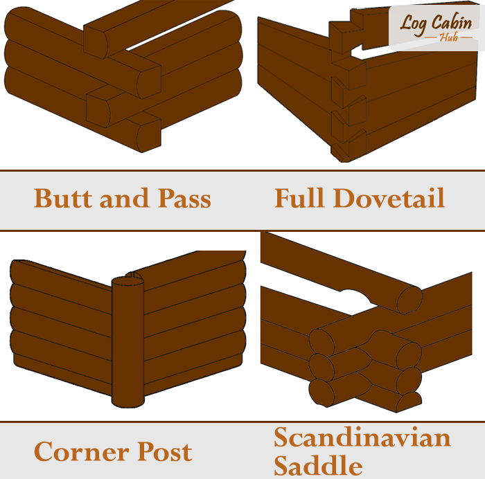

I plan on scribing them and doing scandanavian saddle notches like this image.
# Posted: 7 Feb 2020 10:45pm
My first log home we did a Norwegian scrib. That is a saddle notch on the ends and also length wise scribe... a v-notch length wise so the top log sits tightly to the log below. The length wise v is filled with insulation before setting it on the log below. A lot of work but you can make a tight home with this method.

Use the butt-n-pass method, pin together with rebar.
Pin in the corners horizontally to lock the corners, then pin along wall every 2 or 3 feet, stagger the pins on each row. This is how the LHBA does it. Be done in a weekend.
