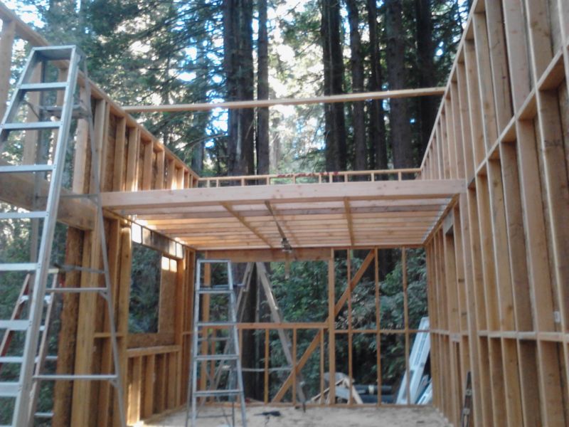

I'm no builder either but I wanted to save height on my loft so used 2x6s on 1' centers, and only 12' wide. I only use it for storage but for a bedroom it would be fine, doesn't seem to flex at all.

I had to look up knee walls..the walls are all 12' studs, the loft was an afterthought. Roof pitch was limited to total building height restriction of 15'. IIRC I looked up the 2x6s, which I already had leftover from the bundle I bought for rafters, in the span table online and they were acceptable on 1' centers. My wife can't get up there so no use as a living or sleeping area.
As I said I'm no builder. The whole cabin was a last grasp effort to do something to enjoy the property. And we've done that quite a bit.
