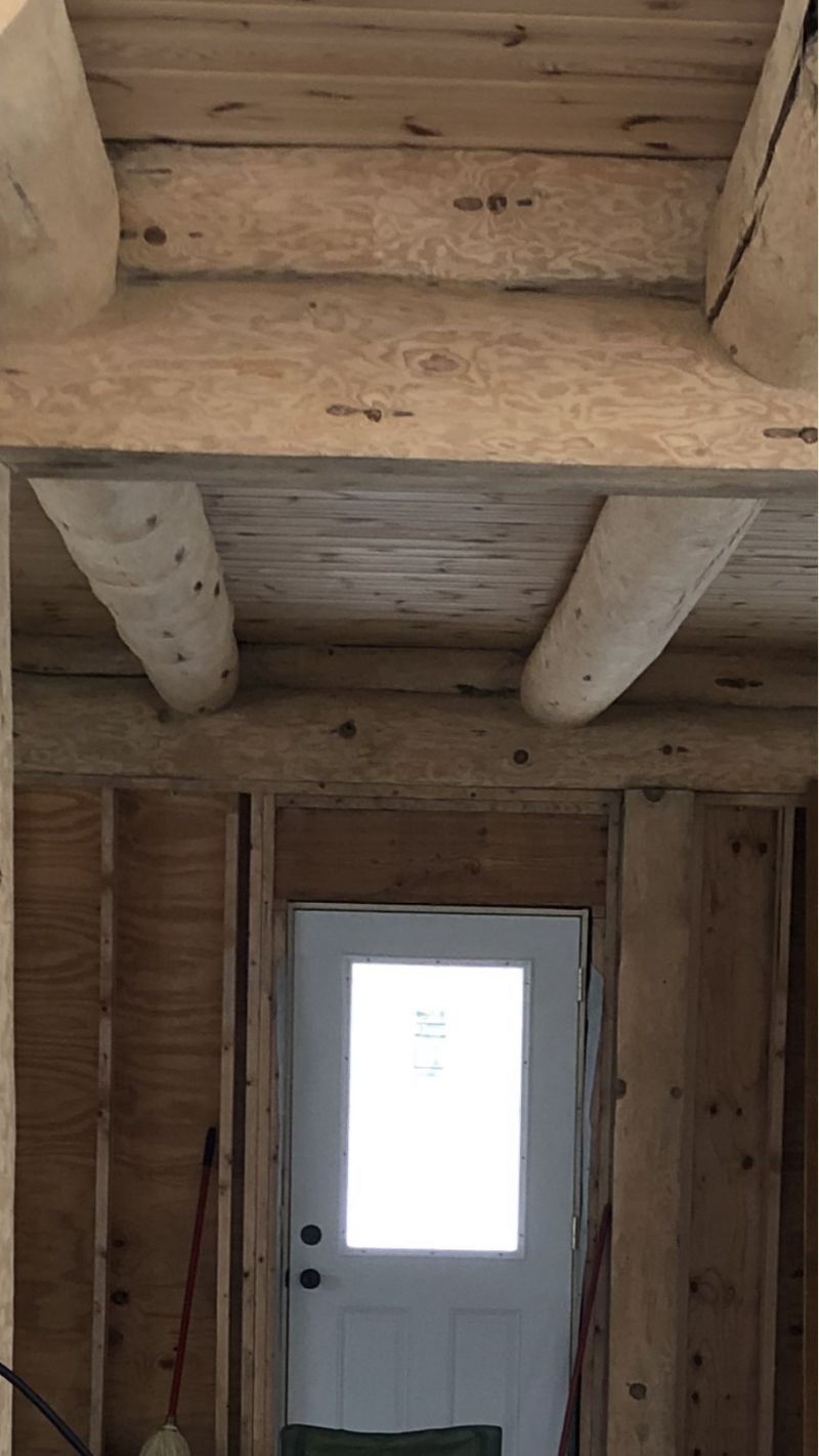

Hi guys. I’m back, this time in need of some creative minds regarding my cabin plumbing and I know someone here has an answer.
I need to find a way to construct a pipe chase to conceal about 15 feet of horizontal 2†pvc vent pipe and 2 pex water lines. If you look at my pic, the pipe has to be routed across the top of that door. I cannot cut into that log and we have no other options but to run the pipes across that log or maybe just below it. Any ideas?

# Posted: 13 Feb 2020 12:42am
Where is all that piping entering the picture from?
hijlehhw
# Posted: 13 Feb 2020 02:21am
Could build a tray with PVC/PEX inside and then run LED strip also to make it look like it was planned accent piece rather than what it is.
This guy does something similar but with crown rather than a box like you would need, but its enough to give you an idea of what I mean. Could trim it out in nice wood/stain and actually might look really nice depending on your skill set. Log work takes tons of planning and some people forget about that when not using traditional building methods.
Is the cabin on a slab or full basement?
# Posted: 13 Feb 2020 06:49am
Really the only way to do it is going to be to trim it out. There's really no hiding it if you can't go under the floor below the door.
Find a nice straight log and start carving the back out with a chainsaw. I like the led strip thing.

MJR0311
# Posted: 13 Feb 2020 08:44am
Thanks guys, you’re giving me things to think about. The pipes will be running from a utility room which is to the right of the door, and across the door to a bathroom that’s to the left of the door. The whole thing is built on a slab, no basement.

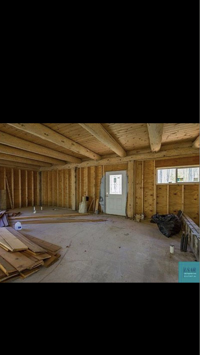

MJR0311
# Posted: 13 Feb 2020 09:06am
Here’s a clearer pic of the span I have to cross. This was taken before my rooms were framed up.
Irrigation Guy
# Posted: 13 Feb 2020 09:12am
Are your framed exterior walls structural? Or is it all on the logs?
MJR0311
# Posted: 13 Feb 2020 09:16am
They’re structural. Above that first horizontal log you see are another 10 logs. It’s a heavy place. I don’t dare bore large holes through those log posts.
Atlincabin
# Posted: 13 Feb 2020 10:13am
I would consider pulling the header from the door and replacing it with something smaller, since it's not really structural (the horizontal log above is taking the load). You mention not daring to bore a hole in the vertical log posts, but I'm not sure why that would be an issue, unless that would almost cut the log in half. If those are 2x6 walls, then a 2" diameter hole would use less than half of the thickness of the logs. A couple smaller holes below/above that for the pex lines. If they're 2x4 walls, then you might lose too much wood. You could also add a couple additional studs next to the log to add strength (though they would have to be bored as well).
Just my opinion, based solely on the photos, so take it for what it's worth. The other suggestions are also viable but you will have to make the judgment on what is right for your situation.
RiverCabin
# Posted: 13 Feb 2020 03:03pm
Fair warning, I'm stupid but no way would I run those across the log.
I'd run a vent in the bathroom either in the wall or through the roof. I know all the good reasons for not venting into a wall but people still do it.
Then I'd run the pex in the wall and bore the logs. Two 1/2 inch hole aren't going to affect structural integrity.
If that absolutely isn't an option, I'd run a channel in the concrete and run them under the floor.

# Posted: 14 Feb 2020 08:25am
I like atlincabins idea, remove the header, put a heavy support across the top of the door opening (4X6 on its side), then little crippler studs to the top, drill through the crippler studs. That massive log eliminates a need for a header I would think over the door. Solves it all and still look good when finished out.
