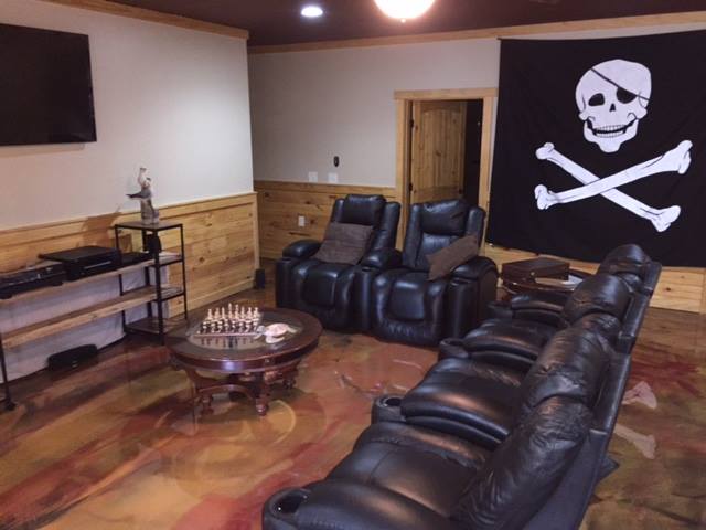

Unless you are set on plank floors, engineered floors do well on concrete. Also epoxy coating look great too. We have epoxy in our basement and in our vet hospital.
Here is our basement:
